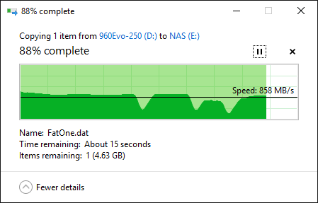

Hi again.
Here are the results with a clean configuration on a single 10Gbit connection with no SLOG attached.
Write:
Read:
I checked again, when the written file is read from the FreeNAS storage - there's no activity at all on the LEDs or the disk activity in GUI Reporting.
Any ideas, please...

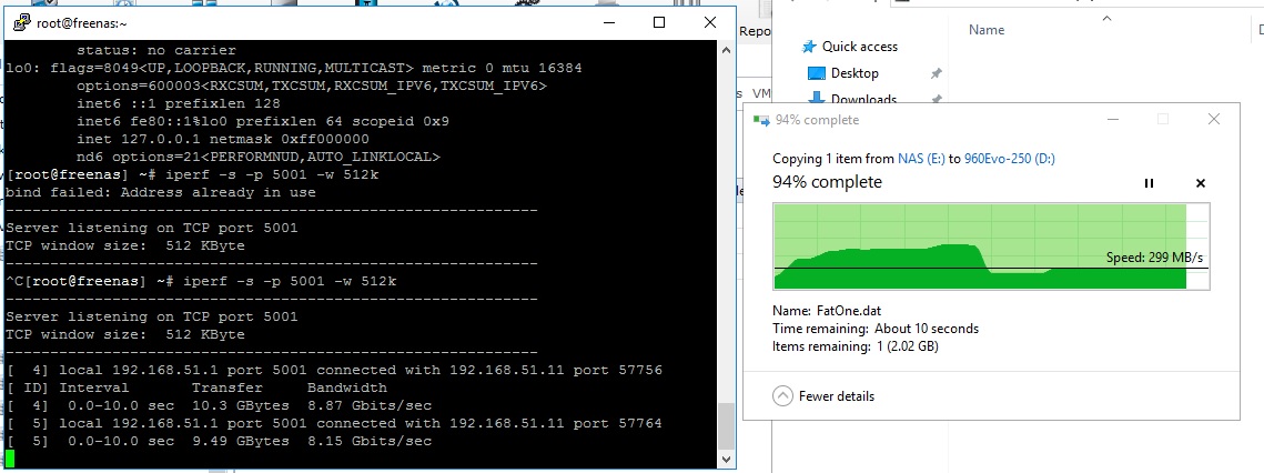

1. I'm not certain on how to use iPerf. I will look it up and will report back.
2. When you say protocol, what do you mean, if you don't mind?
3. I will try direct connection tomorrow, once I get to work.
4. My test PC is a Dell OptiPlex 990 with i7 Sandy, 8GB RAM, S3700 100GB with Server 2016 on it. A test storage only device Samsung 960 Evo that benched seq. 1.4GByte R/W performance in CrystalDiskMark.
Before, the test PC was even a better server, PE R730xd with a single E5-2620 v4, 96GB RAM, H330 controller, with stripe of 2x 200GB Toshiba PX04S Enterprise SSD with 1.7GByte/s R/W.
I'm ruling out the test machine factor. I was getting the same performance on that machine.

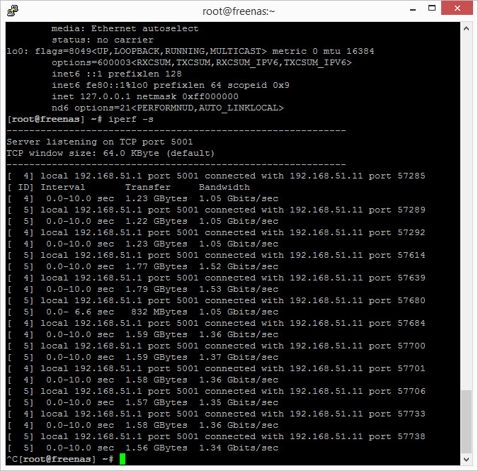

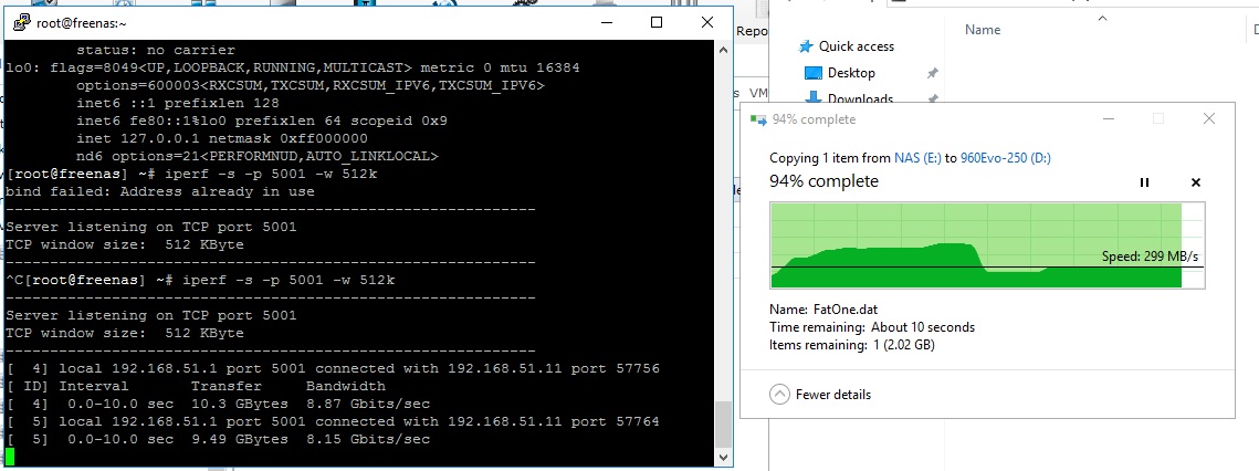

I guess this is no good.
This is with jumbo frames disabled, when enabled the Transfer increased to 1.75Gbit (it's on the pic)
I tried direct attach, avoiding my Dell N4032F switch.
The last 2 results are when direct attached.
Please..
TCP windows size didn't make any difference either.
Tried 512k and got about the same numbers.

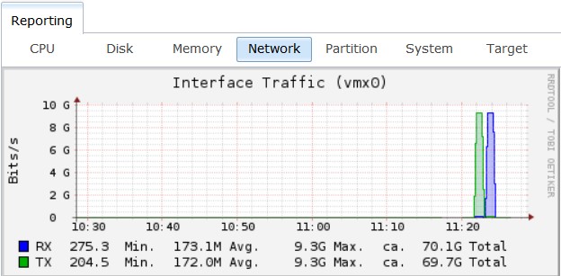

Update.
I'm not sure why, but direct connected FreeNAS and test machine now show close to 10Gbit throughput.
BUT, yet I'm having the same slow read speeds.
No activity on LEDs. All this data is cached in ARC and yet delivering this read speed...
I don't understand this.
