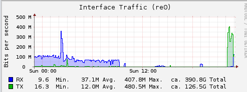

Hello,
First of all, sorry if i made a copy of another thread but could not find solution to my problems.
I have done some research about the data transfer speed for my freenas system because of my problems.
My problem is, the data transfer speed is not getting over 100mb/s while i am having 1Gbits network over iscsi cross cable. Freenas reports about my disks that its only 5mb/s of write speed to my disks.

Look at your network first, FreeNAS is plenty fast "out of the box" if you
follow best practices.
You have two Marvell Yukon controllers, one of them (88E8001) is not listed
on the compatable hardware list for FreeBSD 9.2
The other controller may be supported (not sure about this).
Suggest you first test both ports, if that does not result in improvements,
try adding an Intel NIC to one of your board's expansion slots.
Intel chipsets are best for FreeNAS, search the forum for more info.
See also the Recommended Hardware sticky, fewer problems with server
grade hardware, more problems with desktop hardware, the choice is yours...

Do you know which chipset the TP-Link NIC is using? FreeNAS loves Intel chipsets and they're only $32 US
If the TP-Link NIC is either Realtek or Marvell chipset based, you'll find these to pretty much suck!
How much of the Volume space is used?
- It is over 85%
This is your number one "slow speed" issue, FreeNAS slows way down as the volume fills past 80%
Are you in a testing phase and could try a different setup?
- I can not test on this environment.
Make immediate plans to backup your data and re-configure or expand your pool, and I suggest
adding some redundancy to a new configuration.

RAID-Z2 would not improve your speed, but RAID-Z2 might save you from loosing all the data.
With 85% space utilized only some data operations are not slowed down. Unless some ZFS guru had verified for you, that with your usage patterns the threshold could be above 80%, I would highly recommend staying at below 80% or lower.
Please tell us about your data usage, more about your data in general. It might be that for your needs, space utilization should be no more than 50%.

While 8GB is the minimum amount of RAM needed for a general purpose FreeNAS server, for iSCSI use, one generally needs a minimum of 32GB of RAM.
For best performance with iSCSI, striped mirrors offer best peformance. Consider 3-way mirrors if you need additional redundancy.
And, it's recommended not to exceed 50% of your storage space.

Try a different cable. 100 mbps sounds like the NICs weren't able to negotiate a 1 gbps link.
