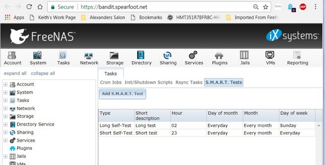

You may have disk problems. If so, you need to address them immediately. There's no point in backing up your servers to this machine if it's soon to fail. You'll end up empty-handed...
I believe the short smart tests are running. It's the default. It's been a while since I looked at those but I didn't recall anything glaring.
For future reference, go to Tasks->S.M.A.R.T. Tests in the WebGUI and see if you have any tests scheduled. If you do, edit the test(s) and make sure all 24 of your drives are being tested. The edit form only shows 4 disks at a time, so be sure to scroll through it, ensuring all of your drives are highlighted. I've scheduled daily short and weekly extended tests on my system, as shown here:
