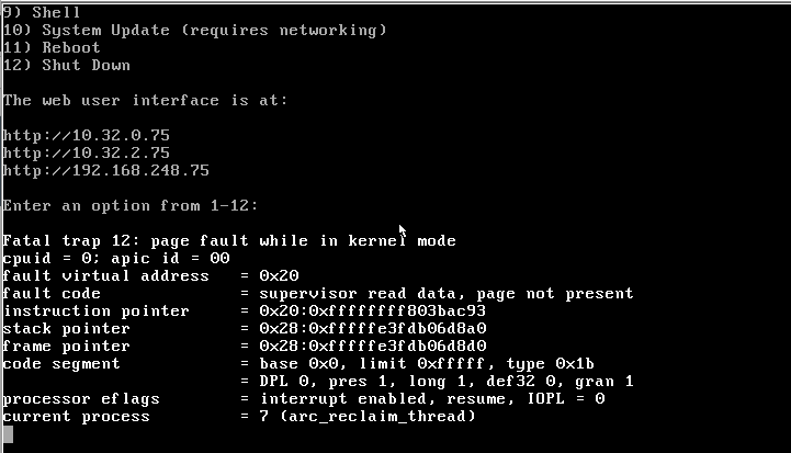

Looks like I have a crash now under the same iSCSI load. Even after swapping out the the 10Gb Intel NICs for Chelsio.
