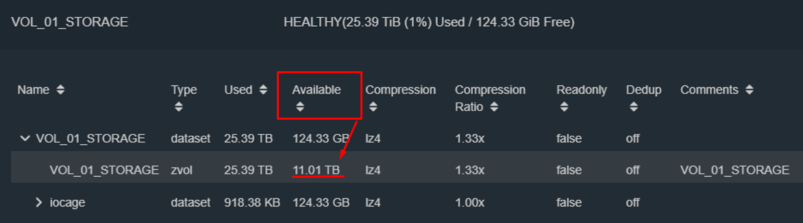

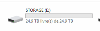

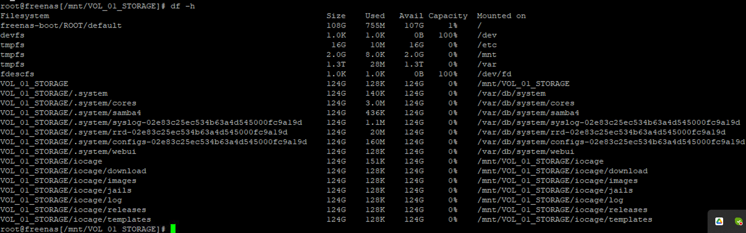

I have a FreeNAS Storage with important data, but after reboot my storage server I haven't acess on the Windows iSCSI conection.
To try solve this problem I ran the chkdsk and now the partition is acessible but I don't see anything there.
Attached there some image tha I capture to show the problem.
Can anybody help me please?

I ran this command on my server and I can see the pool with my data there.

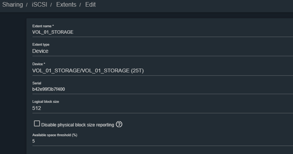

Here you can see my Extent configuration:
But when I acess with my Windows Server on iSCSI conection I can't see my data:
This is not an easy situation to troubleshoot for you and you'll need to figure it out mostly on your own, but we can ask some relevant questions:
  1. Did you by any chance have the client format the virtual disk backed by the iSCSI extent?

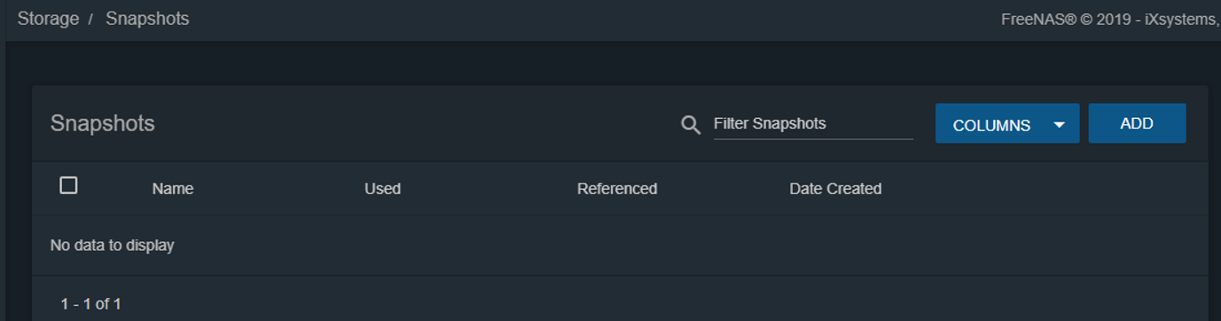

  2. Do you have any snapshots, and if so, what happens if you clone them and mount the clone via iSCSI?

2. No, unfortunately I don't have snapshots

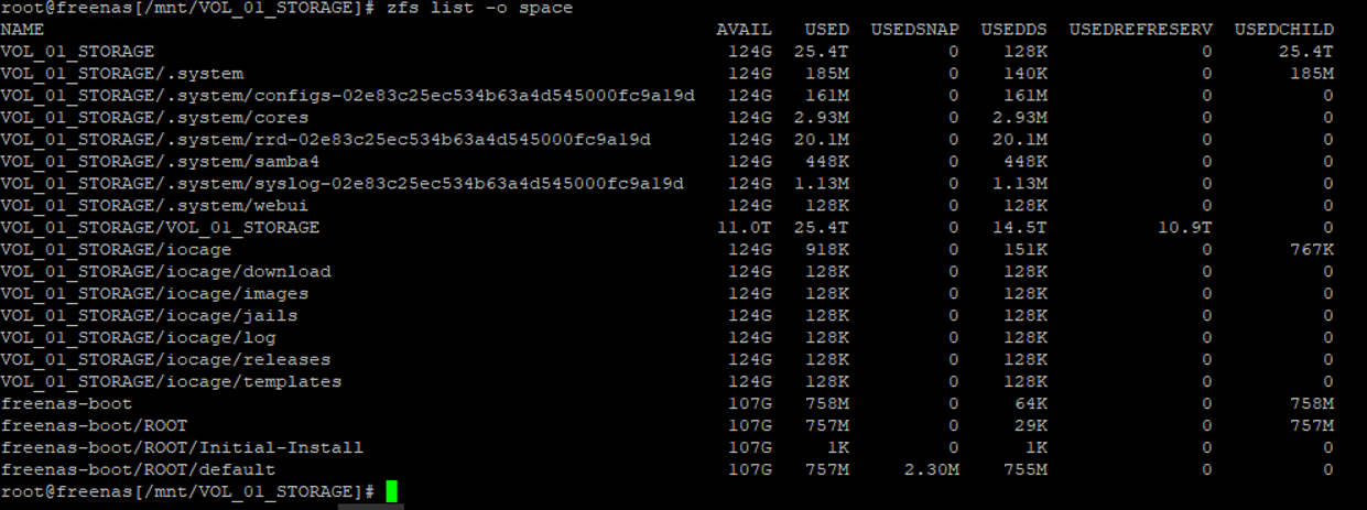

OK, see below:
Well, there's 14.5 TB of blocks actually allocated in that zvol. I'd say there's a good chance you might recover your data with NTFS recovery tools.
Whatever you do, snapshot that zvol immediately and back it up. Then you can try all sorts of things on a third copy, not on the original.

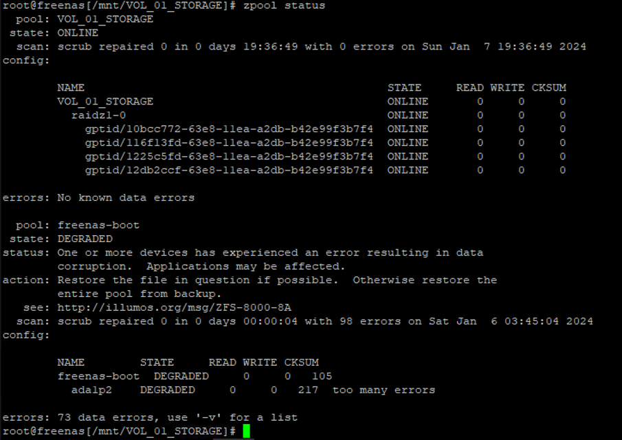

No, that is not at all how it works. I guess it's complaining because of the refreservation.
Before you move forward, what's the output of zpool status?
Well, at this point you have two options to proceed safely.
  1. Get more disks and expand the pool with another RAIDZ vdev (not with a single disk) and take a snapshot.
  2. Create a second pool, with the spare disk, disable the refreservation, take a snapshot and replicate the snapshot.
Beyond that, it's a Windows/NTFS question and you'll need to figure out what to do to the image you'll be working on. Again, back everything up and make another copy to work on.
