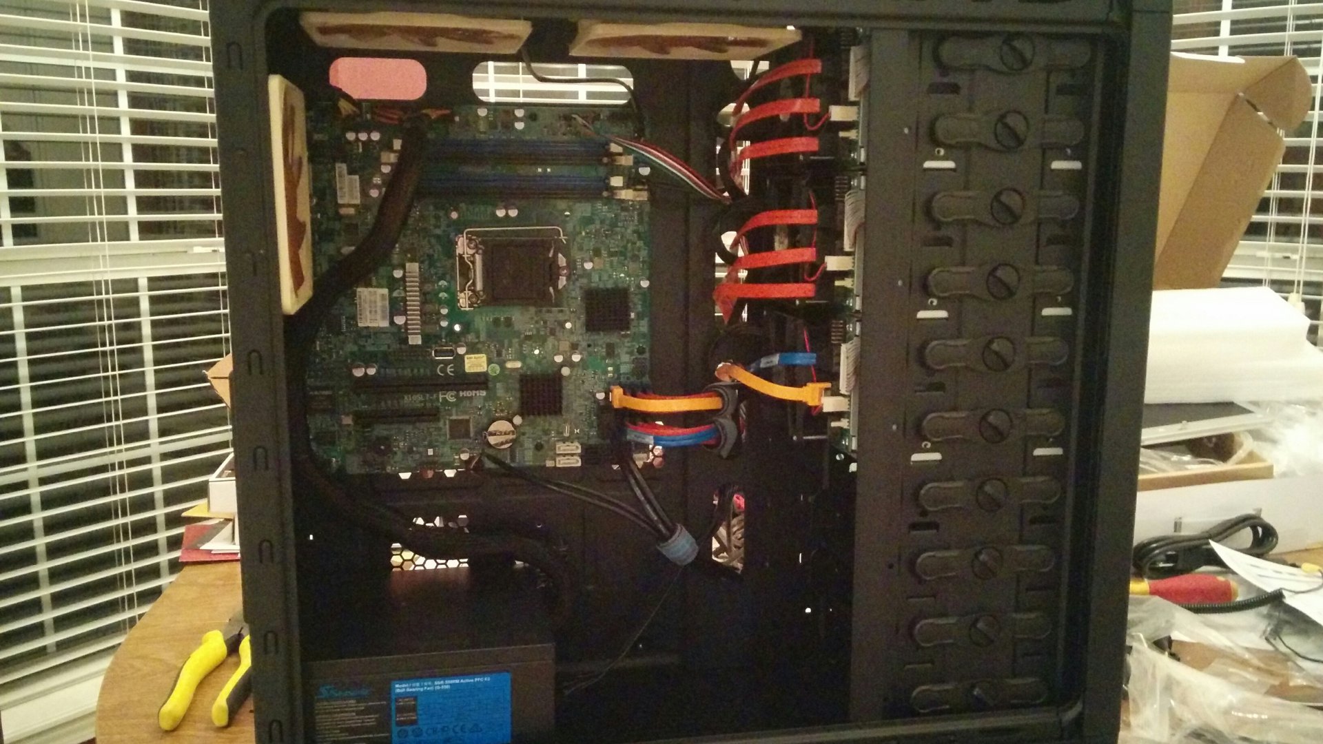

Build is together, Calling it a night in the morning i will be installing the Ram, CPU, and Fan... Then Boot up time!!!!
Picture attached Below!
