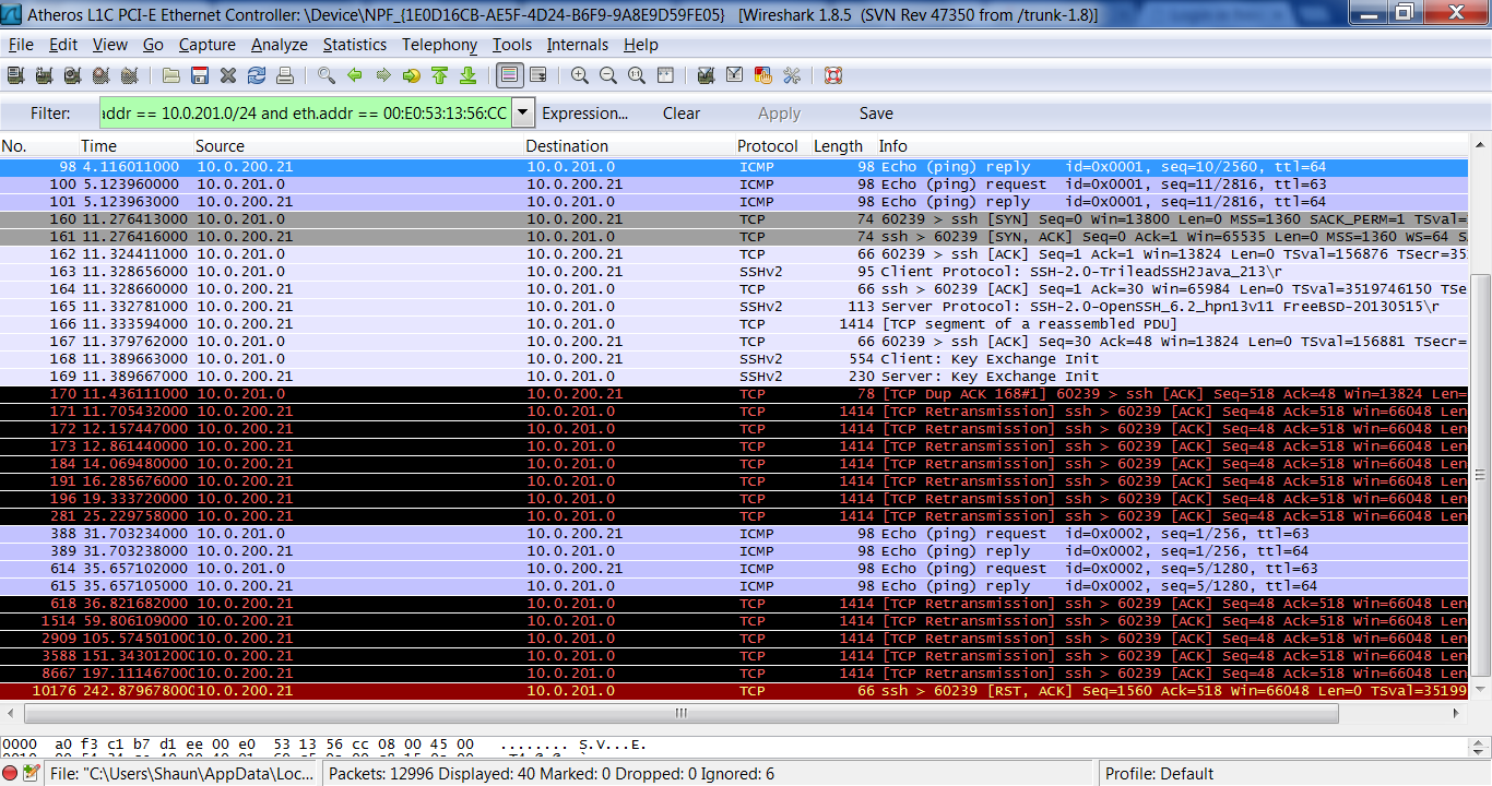

I ran wireshark port mirrored w/ my FreeNAS box and filtered for traffic relating to my VPN subnet AND my freenas ethernet address. See attached picture of the important part of the capture. Here's what I note:
  1. manual pings make it through before the ssh is started
  2. when I start ssh, the initial communication seems to be working
  3. then something happens and it appears that the remote ssh vpn client cannot get traffic to the freenas box, but...
  4. manually pinging while this is happening reveals that ping traffic can make it through!
  5. eventually freenas gives up and send an rst
One thing I also noticed is that packet 166 might be an out of order packet. Not sure about that though.
I have a feeling the problem is very simple. Unfortunately, I've studied this and I think I've reached the extent of my ability to diagnose it. I revisited my VPN settings and can't find anything configuration problems that are consistent with the symptoms here. Would appreciate any help that is offered to me.
Edit: One other strange thing to me is that the VPN client's address's last octet is 0. I thought this was a reserved address. Stupid VPN router won't let me look up the VPN client's address anywhere in the management interface to understand this. Maybe it is doing NAT or something between the VPN subnet and the local subnet? If so, that seems unnecessary and dumb.
Double edit: OK, I figured out why the last octet was zero. That's what the VPN pool was set to on accident. Doh. Still, I ran a packet capture again and the result is identical.
