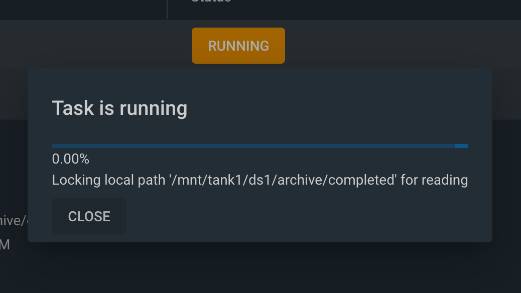

Running a Cloud Sync Task for S3 seems to go nowhere. I have tried created new datasets with clean permissions.
Any suggesting?

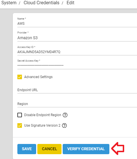

Under System->Cloud Credentials, did you define things like this?
Did you verify your credential by clicking the button?

In principle, it should be possible to run more than 2 cloud syncs at once, but looking at /usr/local/lib/python3.7/site-packages/middlewared/plugins/cloud_sync.py, which implements the job, I see some implementation details that may prevent more than one sync from running:
  • Line 136 starts logic that generates a temporary config file for the rclone job. I don't know if rclone can deal with multiple configs in memory.
  • Line 1001 generates the "Locking local path" message during the job, and if another job is running in the same path, the other job's lock will prevent this job from gaining the lock until the other job completes.
robinmorgan
Jan 8, 2020
36
Great work, thank you for your help. The B2 push and the AWS Push were on the separate datasets. I'm moving everything to AWS deep so this shouldn't be an issue in the future! Thank you again!

You're welcome. It's also possible that you may not have verified the credential at the beginning, and the sync started working once the credential was verified.
