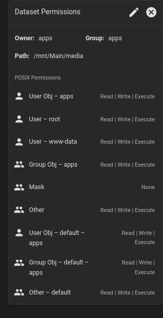

Hi! I've read all relevant threads for Scale and can't get the thing to work. I played with the permissions and currently I have my media folder as in the screenshot. Still does not work. Where else should I look into? I have Core server running too and it works fine on that box though and I remember it was a permission issue as well but I squared it away.

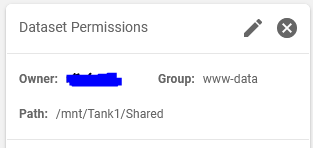

I have this setup working fine (with the TrueCharts NextCloud App). I have the dataset I want to share with www-data as Group in permissions (see pic).

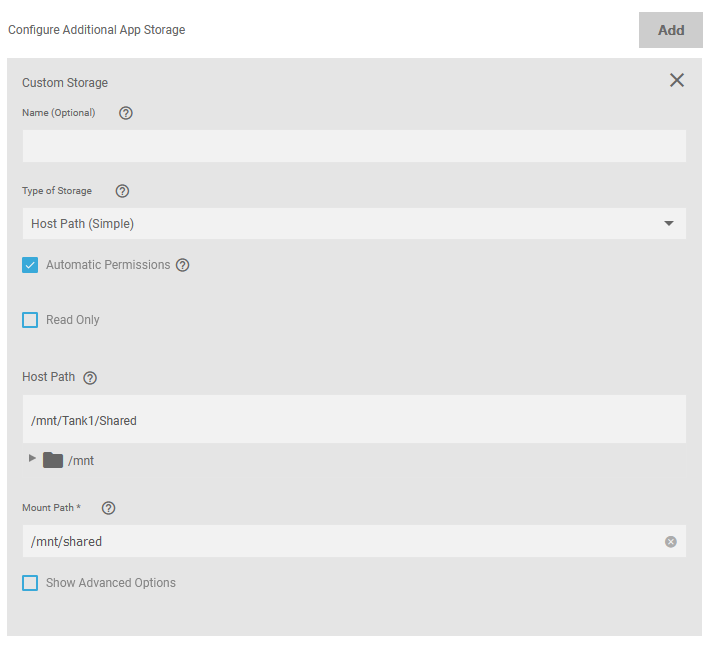

I then have Custom App Storage defined in the App setup (see pic).

mgoulet65! Thanks a lot it worked! The key here was custom storage config!​

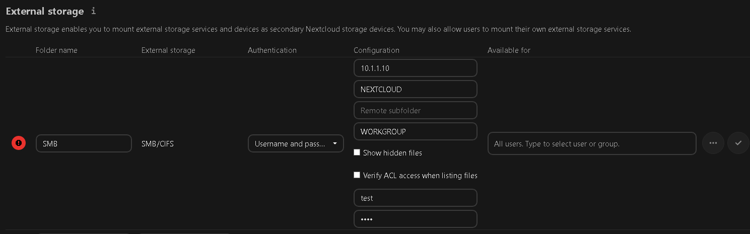

I am not using this configuration anymore due to the Bluefin changes that impact having an SMB Host Path. I add this mount ans an external SMB share from INSIDE NextCloud now.

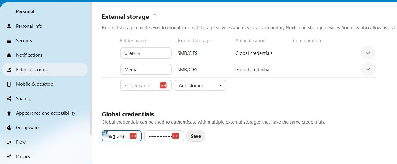

I do not mount any paths in the App setup. I add an SMB Share INSIDE Nextcloud per pic below.
