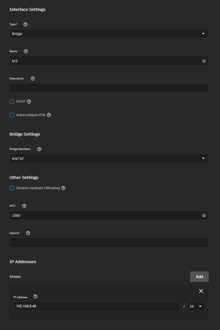

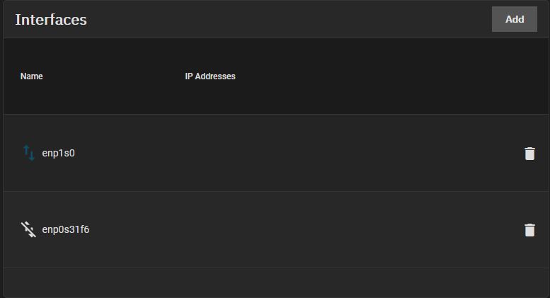

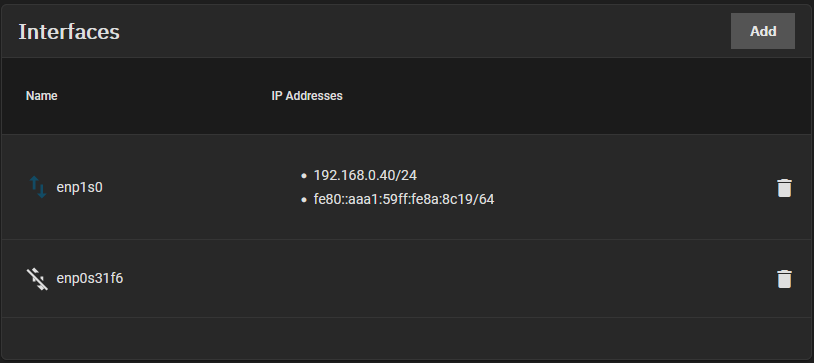

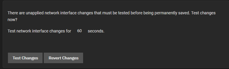

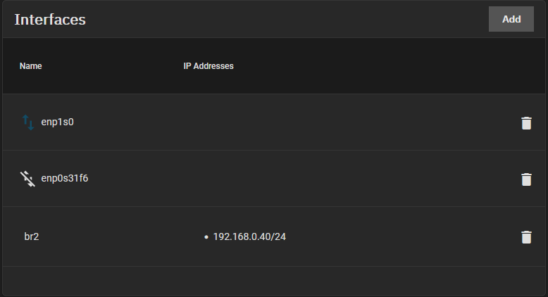

Hello,
I have the same problem, but when I try to test configuration the NAS become unreachable (The app on truenas are not accessible and the router doesn't see the NAS) and after 60 seconds Truenas revert the change and I can access to the NAS but the bridge disappear obviously.
I am in : TrueNAS-SCALE-21.08-BETA.1
Before the step 1:
Step 1: I uncheck DHCP
Step 2:
step 3:
I "Test Changes" and the I recover the access to the NAS 60 seconds later.
Do you think it's a bug or I miss something? (I have second NIC but I haven't free place on the router)
