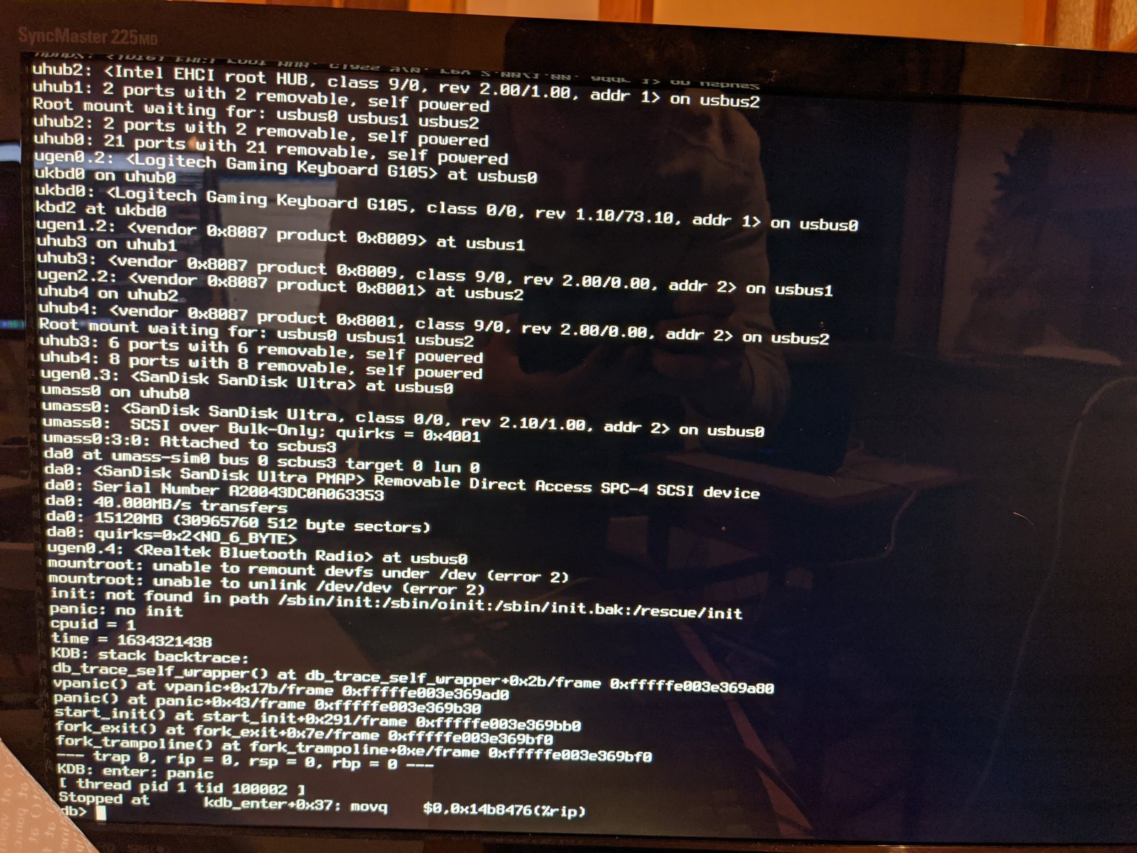

This is where the issues continued. I used a different Sandisk USB, downloaded latest Truenas core (12.0-U6), followed the instructions to use Rufus to get it flashed over. When I insert the USB, I get the boot menu (1. Boot Truenas installer (Enter), 2. Boot Truenas installer (Serial Console), etc.). I press 1 to commence the install, then always get hit with this error (used OCR so may be some slight errors - image below too):
uhub2: <Intel EHCI root HUB, class 9/8, rev 2.00/1.00, addr 1> on usbus2 uhub1: 2 ports with 2 removable, self powered
Root mount waiting for: usbus0 usbus1 usbus2
uhub2: 2 ports with 2 removable, self powered uhub8: 21 ports with 21 removable, self powered ugen8.2: <Logitech Gaming Keyboard G105> at usbus
ukbda on uhub8
ukbdo: <Logitech Gaming Keyboard G105, class 0/0, rev 1.10/73.10, addr 1> on usbus
kbd2 at ukbd0 ugen1.2: <vendor 0x8087 product 0x8009> at usbus1
uhub3 on uhubi
uhub3: <vendor 0x8087 product 0x8009, class 9/8, rev 2.00/0.00, addr 2> on usbus1 ugen2.2: <vendor 0x8087 product 0x8001> at usbus2
uhub4 on uhub2
uhub4: <vendor 0x8087 product 0x8001, class 9/8, rev 2.00/0.00, addr 2> on usbus2 Root mount waiting for: usbus usbus1 usbus2
uhub3: 6 ports with 6 removable, self powered uhub4: 8 ports with 8 removable, self powered
ugen8.3: <SanDisk SanDisk Ultra> at usbus
umassa on uhub
umass8: <SanDisk SanDisk Ultra, class 0/0, rev 2.10/1.00, addr 2> on usbus umass0: SCSI over Bulk-Only; quirks = 0x4001
umass0:3:0: Attached to scbus3
daß at umass-simo bus 8 scbus3 target 8 lun 0 daß: <SanDisk SanDisk Ultra PMAP> Removable Direct Access SPC-4 SCSI device
daß: Serial Number A20043DC0A063353
daß: 40.000MB/s transfers daß: 15120MB (30965760 512 byte sectors)
daß: quirks=0x2<NO_6_BYTE>
ugen8.4: <Realtek Bluetooth Radio> at usbus
mountroot: unable to remount devfs under /dev (error 2) mountroot: unable to unlink /dev/dev (error 2)
init: not found in path /sbin/init:/sbin/oinit:/sbin/init.bak: /rescue/init
panic: no init
cpuid = 1 time=1634321438
KDB: stack backtrace:
db_trace_self_wrapper () at db_trace_self_wrapper+0x2b/frame vpanic() at vpanic+8x17b/frame 0xfffffe883e369ad0
panic() at panic+8x43/frame Øxfffffe003e369b30 start_init() at start_init+8x291/frame 0xfffffe003e369bb8 fork_exit() at fork_exit+0x7e/frame Oxfffffe003e369bf0
fork_trampoline() at fork_trampoline+Bxe/frame Oxfffffe003e369bf0 --- trap B, rip = 8, rsp 8, rbp = 8
KDB: enter: panic [ thread pid 1 tid 100002 1
Stopped at     kdb_enter+0x37    :movq     $0,0x14b8476(%rip)
db>
I have tried other USBs - no luck. I have properly formatted and cleaned them to give them a new start - no luck. They are all USB 3s, I've put them in the USB 2 port and same result. I have tried a USB SD card reader and has the same result. When I use a USB in my PC and set it as the bootable drive to see if I can even get to the installer menu - IT WORKS FINE! It seems to be an issue with the USB on the MB only letting me get so far into the install. I've updated the BIOS, turned off and on as many settings as I can see that might impact based on my research. Still scratching my head. No one else seems to have had this exact issue in my searches. When I put the ISO on the SSD and tried the installation - worked fine. I would just try and used 2 SSDs - one for OS and one for ISO, but I don't have enough SATA ports as I have all my other HDDs attached. (can I remove them while I do the install, then ass them back when I go to restore my previously saved config?)

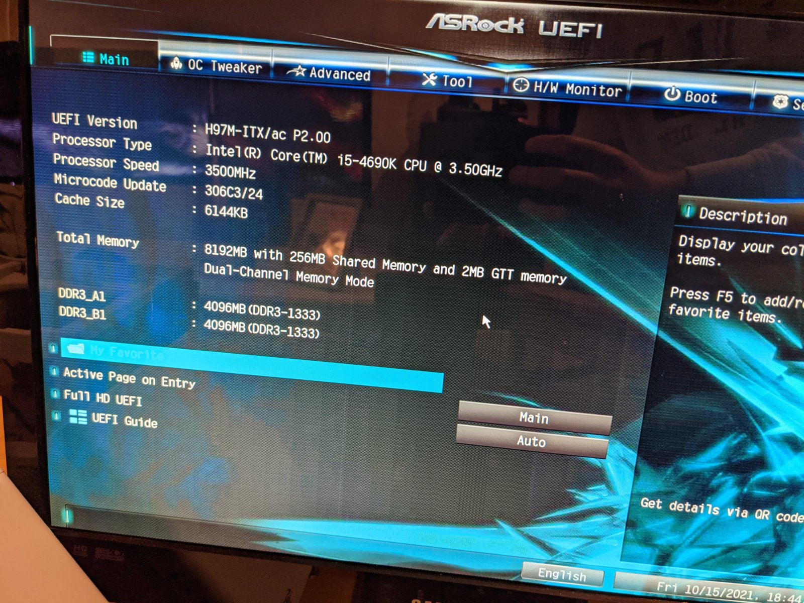

  • Motherboard make and model - Asrock H97M-ITX/ac
  • CPU make and model - Intel Core i5 4690k
  • RAM quantity - 8GB
  • Hard drives, quantity, model numbers, and RAID configuration, including boot drives - x1 WD Green 2TB, x2 WD Blue 2TB, x1 WD Green 1.5TB, x1 Integral V-Series SSD 120GB (will be for OS)
I think it's possible that you don't have a good download of the ISO, so I would repeat that step at least and start afresh. Use the checksum to validate the download following the validation described in the docs.
I know you say it "works fine" in two test situations you tried but in neither did you report that it actually created a working installation.
In the case of the iso on the SSD, if you had another sata ssd you could attach that to a sata port if you temporarily remove your HDD's.

Thanks for coming back to me so quick and sorry for the delay - I ordered another SSD, and I have been able to get things back up and running that way. Unfortunately it doesn't explain the issue I was having - strange that USB would suddenly stop being accepted on my system, but not entirely.
I'll mark this as resolved (if I can figure out how!)
