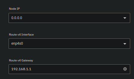

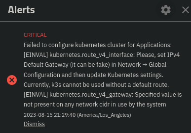

Hi.
After setting the default route for my k3s, I still get the following error :
kubernetes.route_v4_gateway: Specified value is not present on any network cidr in use by the system

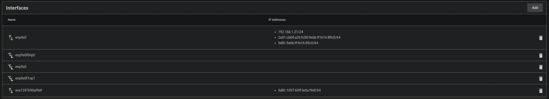

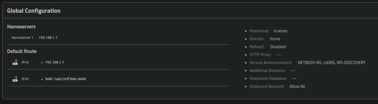

However, the k3s gateway is set to 192.168.1.1, and I have a NIC with address 192.168.1.21/24.
I've had this issue before on another consumer grade bare-metal system which had a single NIC. However, another deployment on a VM worked without problems. Any idea what's causing this ? Did I just miss something obvious ?

And have you set that in Network | Global Configuration too? (as suggested in the message)

OK; and what about setting the Node IP to 192.168.1.21 ?
9,703

Have you set that IP address as static?
Maybe also time to consider using a Bridge to do the networking properly while you're there.

I set up a bridge interface like you recommended, then set that bridge interface as my k3s interface and it worked. Thank you!
I'm still confused as to why I had to do all this on my bare-metal system, but not on the TrueNAS test VM I'm running on my desktop. Any ideas ?
