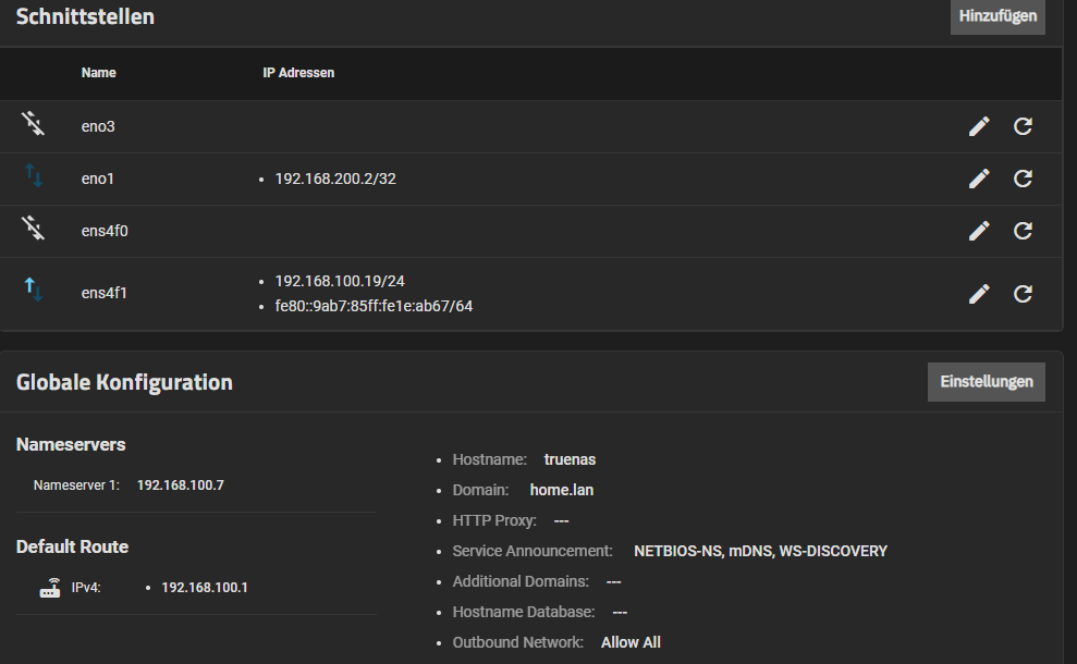

I have 4 NICS, 2 of which are in use. One with a static IP for my DMZ (eno1) and one with DHCP (ens4f1) for my green network.
I'd like to set a static ip to this green NIC. Whenever I do that, I end up with no network access at all, from none of the two NICs, because there is no default route anymore. All I have, route-wise is:
netstat -r
172.16.0.0/16 dev kube-bridge proto kernel scope link src 172.16.0.1
Thanks

Patrick M. Hausen
Nov 25, 2013
7,776
Yep, the default route goes into the "Global Configuration" section after you configured the static IP address on the bridge. No problem when configuring locally, might cut your connection when working from remote, so better have e.g. an RDP session to some system at the location of the TrueNAS instead of a direct connection from your browser. If you are working from remote.
Thanks a lot for the tip.
Unfotunately, I lose all network connections. The machine cannot access any of the networks, including the local one. Only the console works, no access to the LAN whatsoever. The routing table does only contain this "kube-bridge."
No idea what to do :-(
