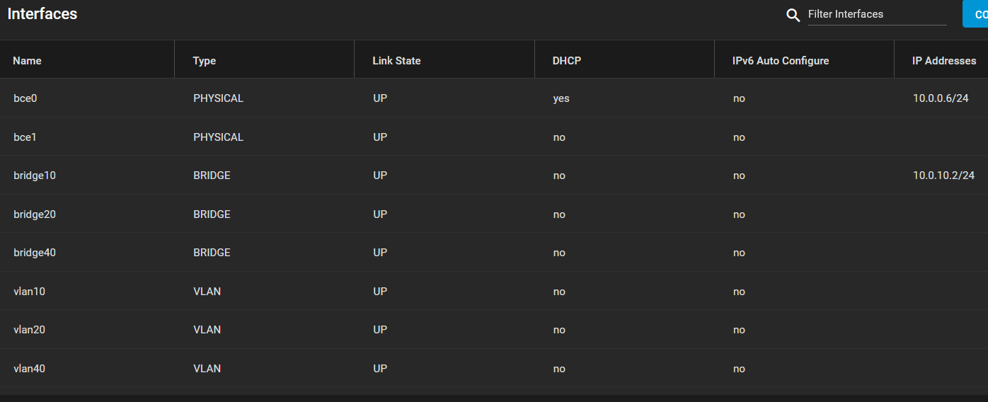

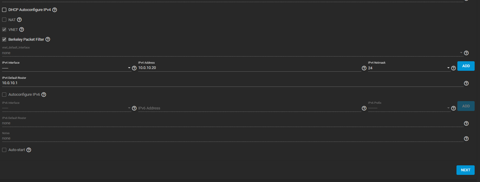

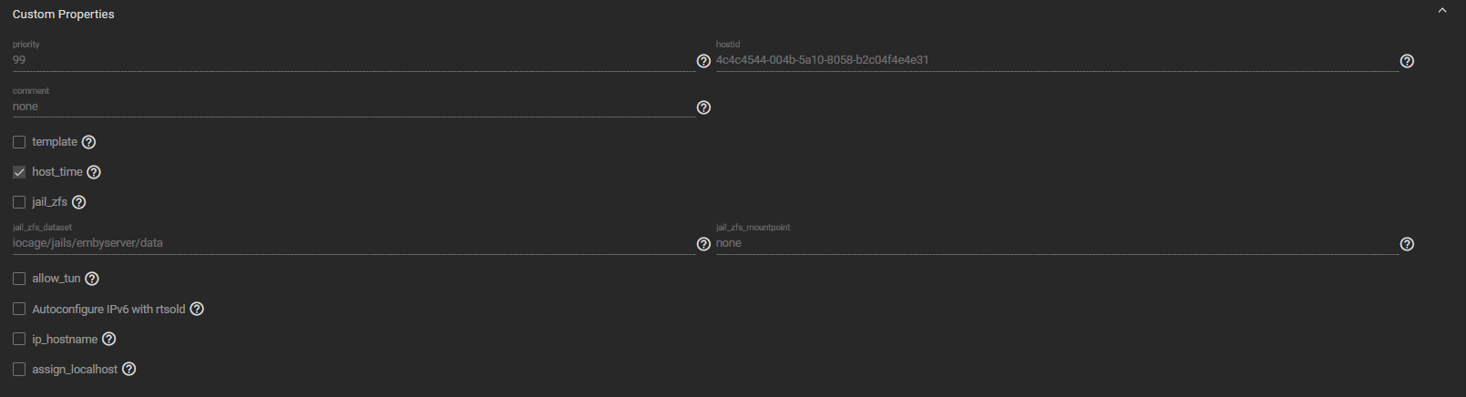

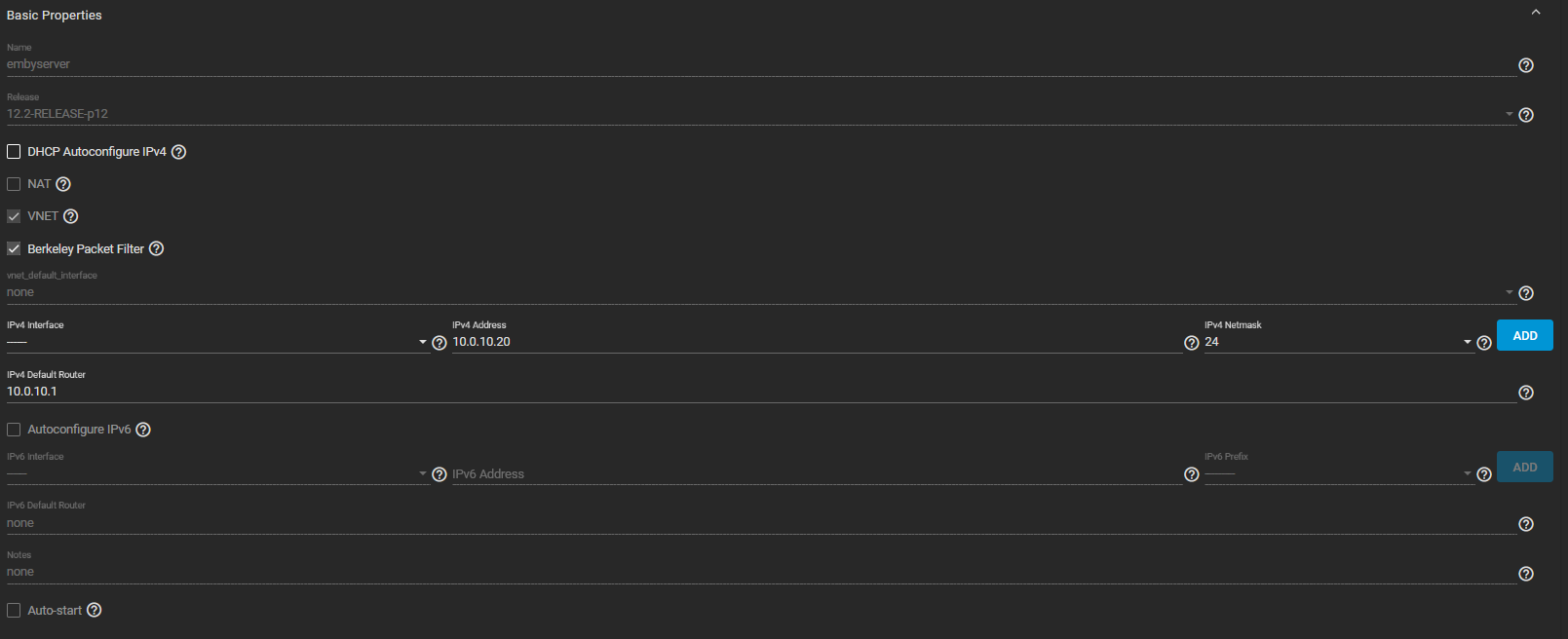

I had en emby jail in the same subnet than my admin. I wanted to move it in the IOT VLAN. Since I made this, I can't ping the internet so something must be wrong with my setup. I'll post the GUI screen shots but CLI is required, I'll post them provided I'm told how to.

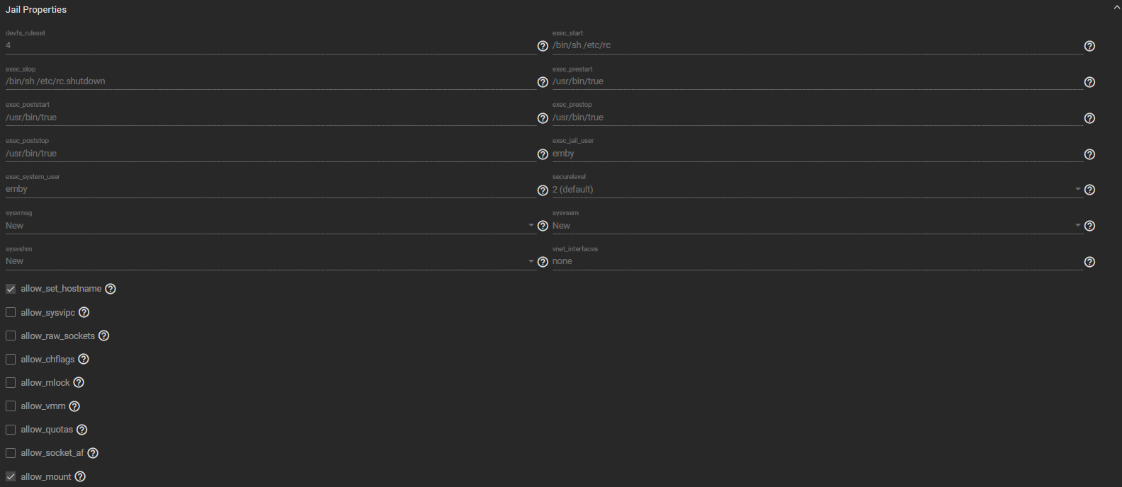

Set the vnet_default_interface to "auto"

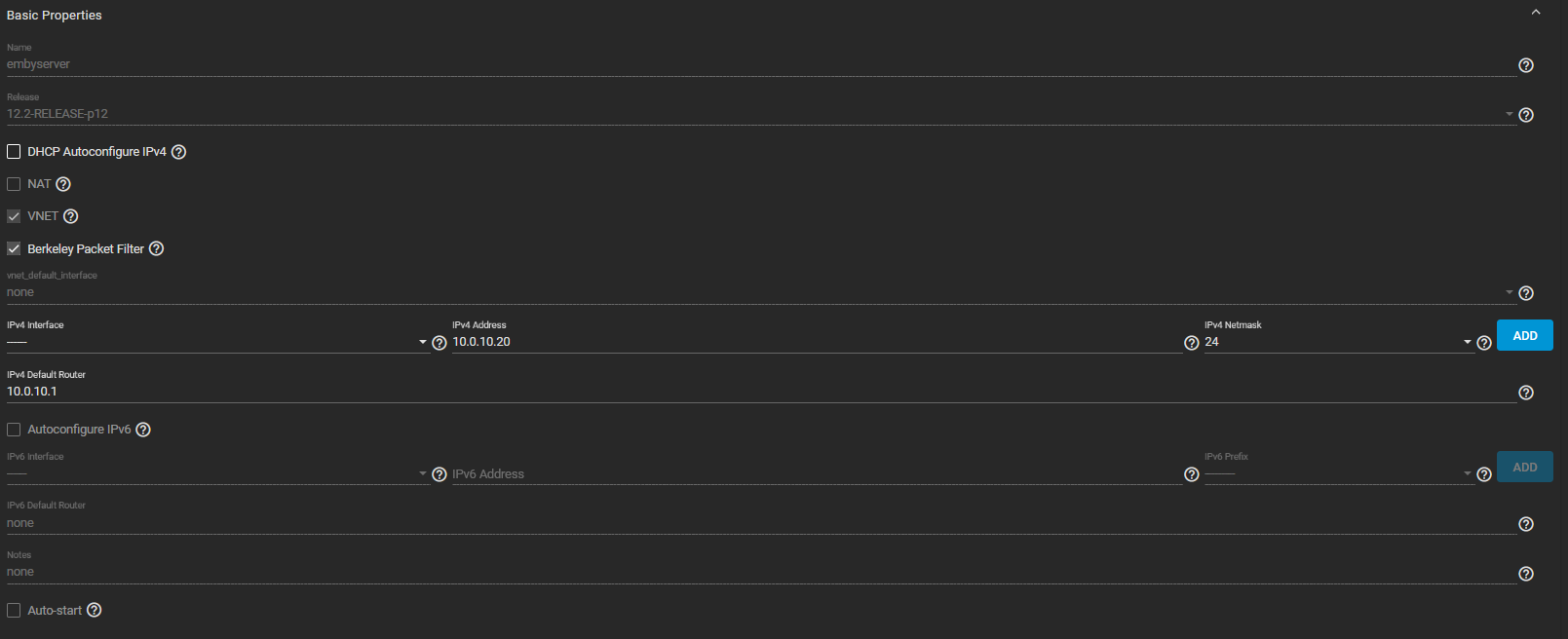

In my setup "resolver" is set to "/etc/resolv.conf"
see the popup note

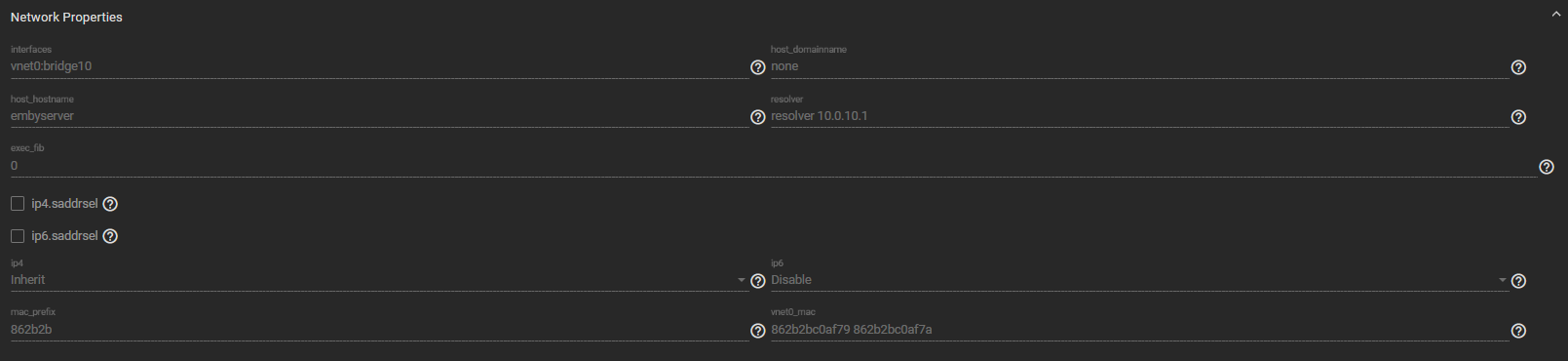

What solved it was: in the Network tab, under resolver, I had typed : « resolver 10.0.10.1»
Where it should have been : « nameserver 10.0.10.1»
For jails in VLANs, one should read:
