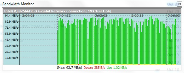

I transferred a 7.7gig file between the two machines about a dozen times each way and ran the smartctl read and write test a couple times. The counter didn't change from the 300 it was before I started moving data.
Looks like transfer speeds are up, just not steady. This is good news right?
I would be helpful if you tried to clarify what the current status actually is with regard to your CIFS performance? Do you actually have a problem?
Current status was posted.

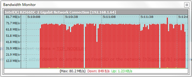

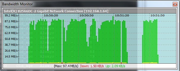

I did some research on the changes recommended so I had some idea what we we are doing. Thanks for the help.
Here's the first write I did after the changes and a reboot. Looks much smoother and faster.
And here's the read.
You can likely tune this a bit further, but it's not worth it with 8.3 nearly ready for release. With all the ZFS changes and improvements you would need to tune it all over again.
