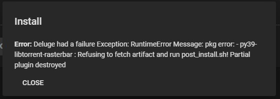

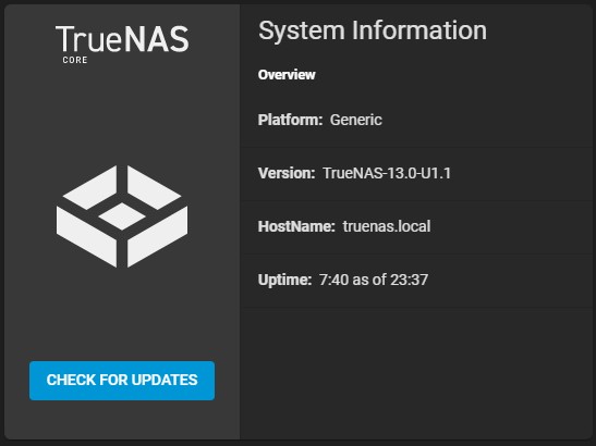

Does anyone have an update on this matter? I'm newbie and I am trying to install deluge plugin on TrueNas TrueNAS-13.0-U1.1, but whenever I try to install it an error message pops up and the installation is cancelled with the following error message
Error: Deluge had a failure Exception: RuntimeError Message: pkg error: - py39-libtorrent-rasterbar : Refusing to fetch artifact and run post_install.sh! Partial plugin destroyed
I've googled for a solution but I found nothing relevant... Any ideas?
I attached my TrueNas version and the error message that pops up when installing deluge.
Thanks!

The plugins are pretty much broken. @danb35 had brought up this topic recently, so I would defer him for additional details.
