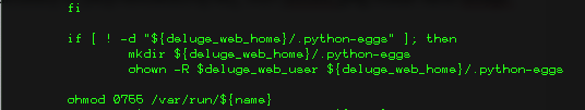

The deluged service starts just fine, but deluge_web doesn't:
root@deluge:/usr/local/etc/rc.d # service deluge_web start
/usr/local/etc/rc.d/deluge_web: 67: Syntax error: "}" unexpected (expecting "fi")
...and indeed, when I look in the rc file, there seems to be a missing "fi":
That's easy enough to fix. More problematic is that it insists on putting files into the user's home directory, even when deluge_web_confdir is pointing somewhere else. And since media has a home directory of /nonexistent, it fails. A simple short-term fix would be to give media a home directory, but it doesn't seem like this should be necessary. Thoughts?
Wizened Sage
11,564
Looks like that has been since fixed upstream
Well, the first problem has. But since it's easy enough to give the user a home directory, a step in the right direction.
