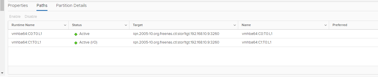

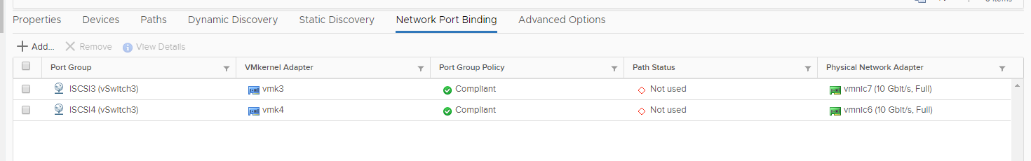

I connect FreeNAS with ESX directly using both 10Gb ports. I am attaching EX PATHS since I don't think this is right. I should them both have active 10GB when using ISCSI - correct?

drinking12many
Apr 8, 2012
148
You have to set your paths to in ESX to either round-robin or alua to get it to use both paths. It really only helps if they are super busy. You can also use a script and powercli to do this on all devices if you have a bunch. I used to use something like this at my last job it only sets it on drives over 100GB though as written.
Get-VMHost | Get-ScsiLun -LunType disk | Where {$_.MultipathPolicy -notlike "Fixed" -and $_.MultipathPolicy -notlike "Roundrobin"  }  | Where {$_.CapacityGB -ge 100} | Set-Scsilun -MultiPathPolicy RoundRobin
