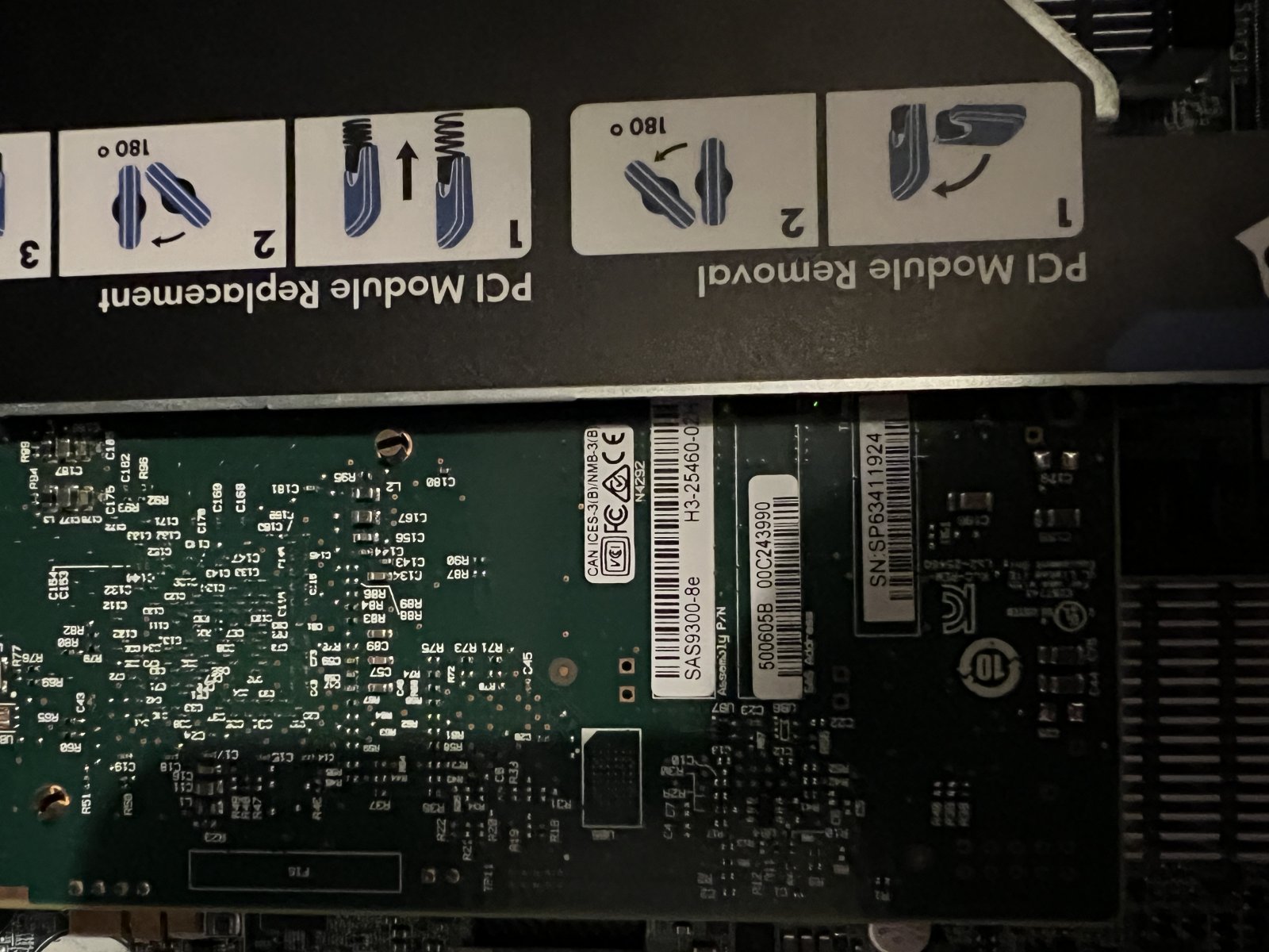

I got a SAS9300-8e (H3-25460-02H) installed.

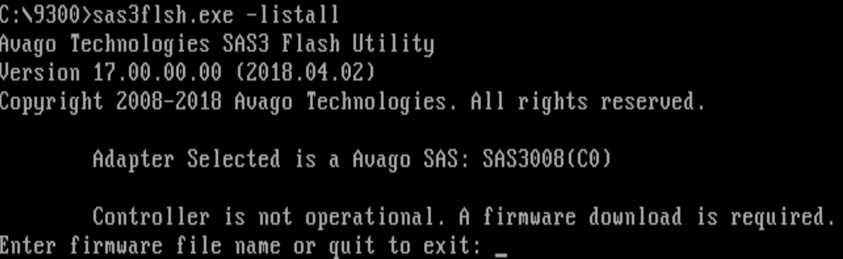

Trying to List all
This did work before i started.

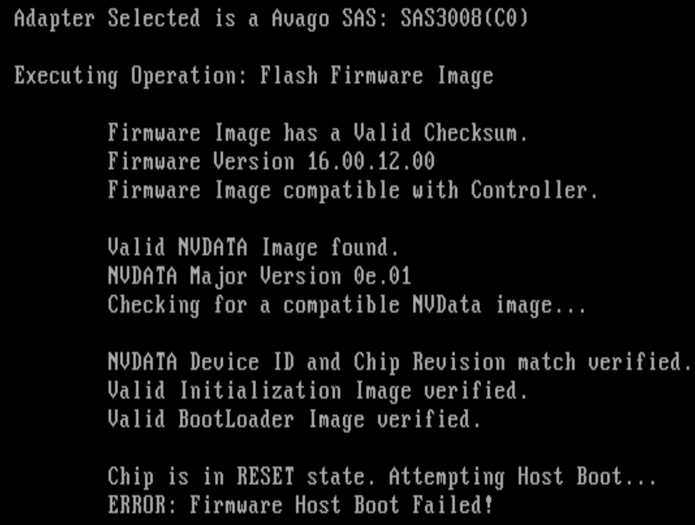

Trying to flash new: (SASNEW.bin is from the TureNAS Post)

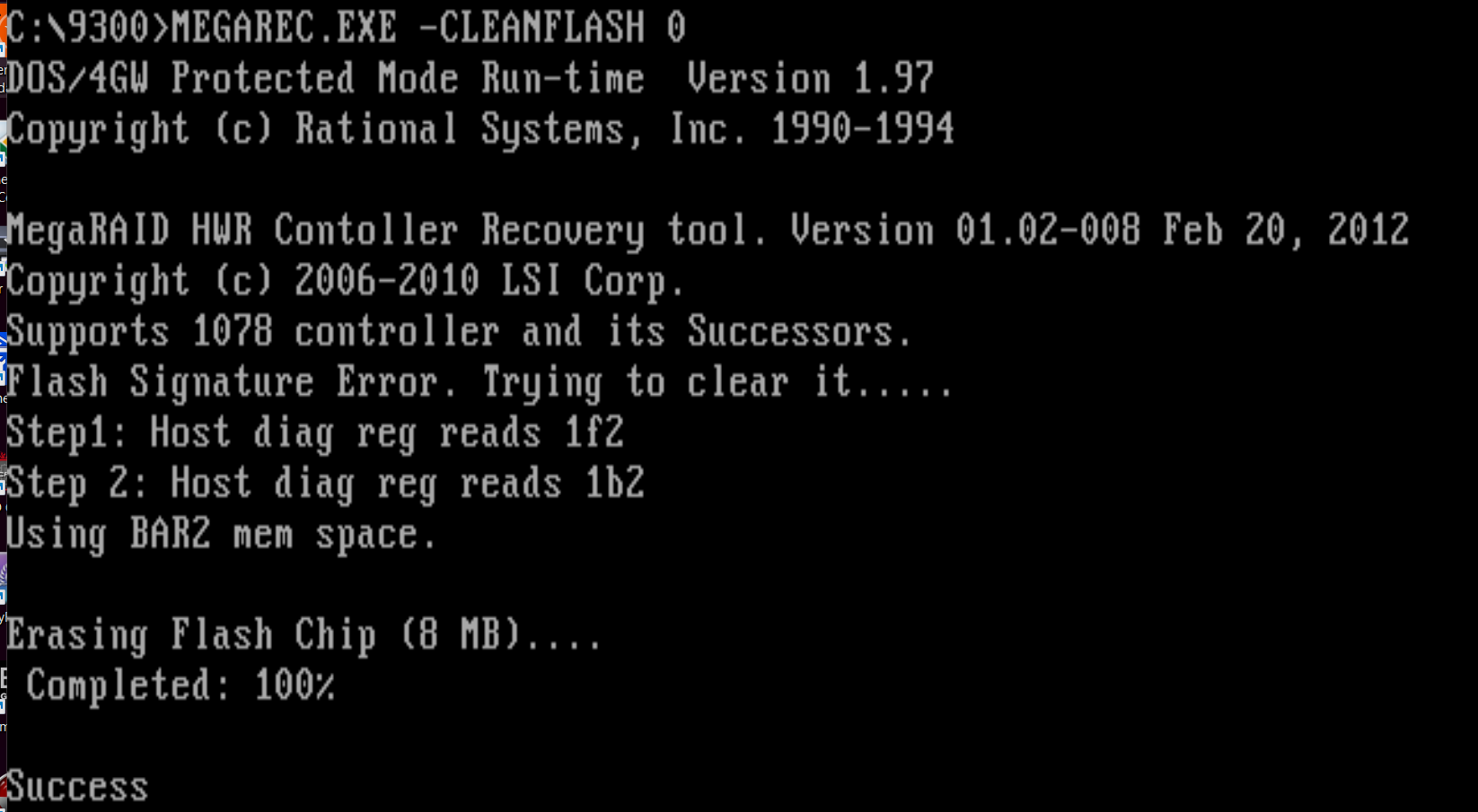

CleanFlash also works:
I'm not sure what to do now?
I hope somebody can help me.

I tryied both from the TrueNAS Version:
SAS9300_8e_IT_acm.bin
SAS9300_8e_IT.bin
But because it is an external Card the ACM Version should be the correct one? I think?

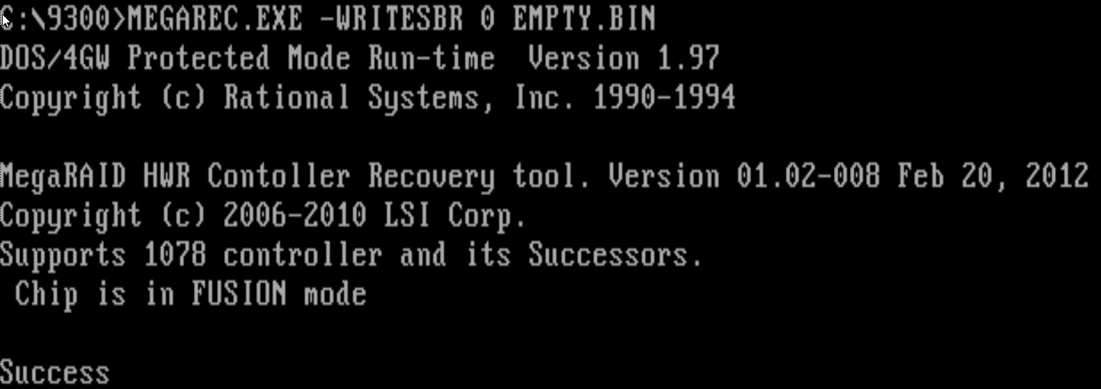

Writing an Empty File works.
Why would you do that!?
WHY?!
I'm not sure whose advice you're following, but stop. All you needed to do was use the UEFI version of sas3flash to update the firmware. You definitely should not have been flashing empty SBRs or wiping the card.
You could use an expert on this topic, and you might get better help over at the STH forums, where this is discussed in depth, but it seems to me that you need to undo what you did and flash the SBR back, flash the card with the proper UEFI tooling, and reprogram the SAS address.
