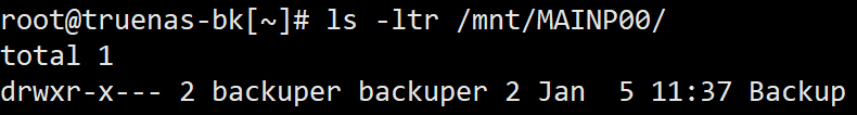

I deployed several Truenas systems, one for primary storage and one as a backup server. Replication is configured and works well. However, I have some weird problems with permissions, particularly on the backup server. This is weird since the same version of Truenas Scale is installed on the main server and no error occurs whatsoever.
Once owner@ and group@ are configured everything is fine:
But once I add the third rule which prohibits any sort of access to everyone@ all previous permissions drop
I noticed it when I lost access to this SMB share.
As a solution I applied to everyone@ special permission when I unmarked all options. But it was a solution until I run a test replication where I had applied "deny full access" to everyone@ (note that the corresponding SMB share from the main server works as expected despite everyone@ has no access as well). Backup server is installed from scratch and at the monent is not populated with data, therefore I am free to reconfigure it.
Does anyone has any idea?
This is working precisely as designed. Denying access to everyone denies access to the owner and group as well. C.F. RFC5661.

msokol
Jan 5, 2023
10
Thank you for the clarification. Once I swapped "deny" access to "allow" without ticking any checkbox, I could successfully open the corresponding backup folder. I had a feeling that "everyone" is different from "others" in Linux. Still, there are a few questions:
  1. Why it did not break any permissions in my main system and I had full access to my data?
  2. What is proper ACL configuration with no access to anyone else which is not listed in the permission list? Normally this list contains owner@ and group@. I would like to block any access to others.

Remove the everyone@ entry.
