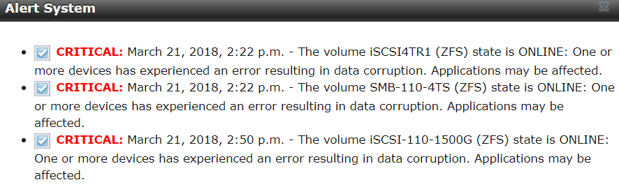

The situation is getting worse, it seems that the alert is happening almost every day now. Could it be a memory issue?
This thread has similar issue and it turns out to be memory related. https://forums.freenas.org/index.ph...orruption-applications-may-be-affected.57337/
Could someone give me a hand here?
Many Thanks,
S.

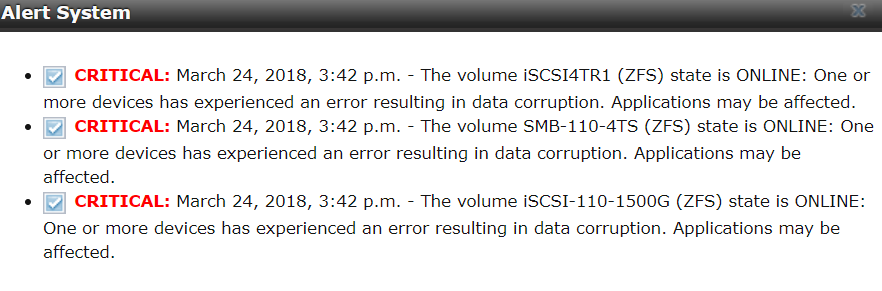

A total of 18G memory ( 3 x Kingston 4G each, 3 x Corsair 2G each). Rerun memtest86 on those Kingston modules with 7 passes without error. Remove Corsair from system.
Currently FreeNAS is running fine and all the issues on storage vMotion and Veeam Backup are all gone with 4-5 different tests.
Tried to get more understanding on FreeNAS log, when I reboot NAS system, the system did prompt me Alert which is the same as before.
Logged into system and found the following for /var/log/messages. Can someone help me?
  • Why it doesn't have log regarding above 3 critical alerts?
  • Does it captured in other log under /var/log?
  • Notice from online that we can download Splunk for free for a daily log data up to 500M. Anyone who can share experience how to setup Splunk with FreeNAS? Can't find much help online. I might open another thread on this topic.
