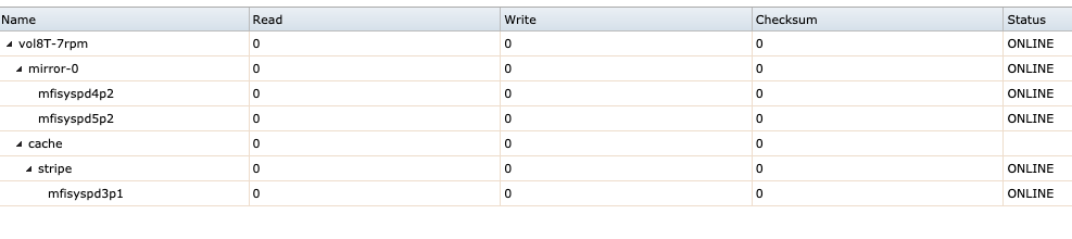

The volume where errors are set is the 2x8TB (mirror) + SSD

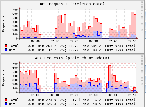

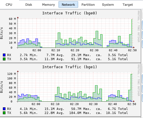

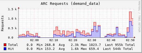

To complete, i see holes in graphs during backup. It show that no more data are received by freenas no ?

jgreco
Resident Grinch
May 29, 2011
18,680
sorry.
I am searching for udev rules.d file for the iscsi initiator (linux centos 7).
You'll need to contact your OS vendor for that, then. FreeBSD is completely different than Linux.
Storage is connected using multipathd on linux, using 2 differents nic:
You probably need to get rid of the jumbo frames. Incorrect configuration is known to cause stalling and all sorts of other crazy problems. You should probably also get rid of multipath. Get a working, stable, basic configuration going FIRST. Walk before you try to run. Once you have a stable basic configuration, introduce one new thing at a time until you identify your problem.

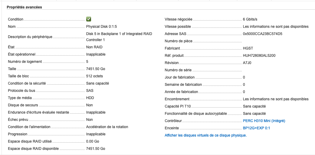

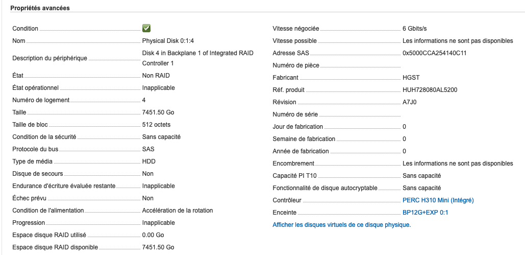

The 8TB disks are:
As you can see, from hardware point of view, they are not confgured as raid device. Mirror mode is configured into freenas GUI.

I cannot disable jumbo frames. I checked from bge* to eth* and there is no errors on my client side.
Of course you can disable jumbo frames. "ifconfig <int> mtu 1500".
"I am only hauling groceries with my truck, therefore I call it a car".
If you are connecting your drives through a hardware RAID controller, they are RAID devices. The drive is being presented to the host as a virtual disk abstraction. The fact that it happens to be a JBOD abstraction is irrelevant. The problem is that you're attaching them through a driver that's known to be a bit flaky and problematic. FreeNAS is known to flood out hardware RAID controllers. The MFI driver is known to stall. The exact interaction there isn't clear, but it hasn't been worth it to anyone to figure it out, because it's the wrong way to attach drives.
