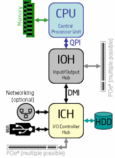

X8DTH-6 / xeon E5620 doesn't have an FSB. Below is a diagram of Nehalem architecture
Thank you. FSB died with the 5400 series and FBDIMMs, and while the 5600 series isn't going to set any benchmark records versus a modern Sandy/Ivy or Haswell, it doesn't mean that they're useless paperweights.
I stand corrected, thank you for that. Seems that many sites list it as having a FSB still. My apologies to the OP of that piece of misinformation, my google-fu was flawed.
It's still got a crappy architecture by the standards of the last half a decade.
