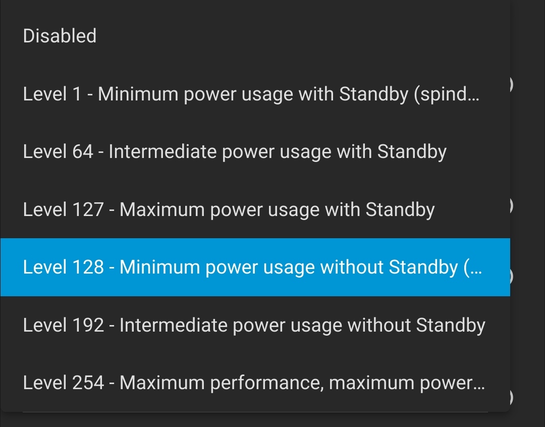

Have you checked this option from the Disk Settings in the GUI?
These settings are both for APM (Advanced Power Management). EPC (Extended Power Control) replaced APM on all (most?) enterprise level Seagate drives a while ago.
