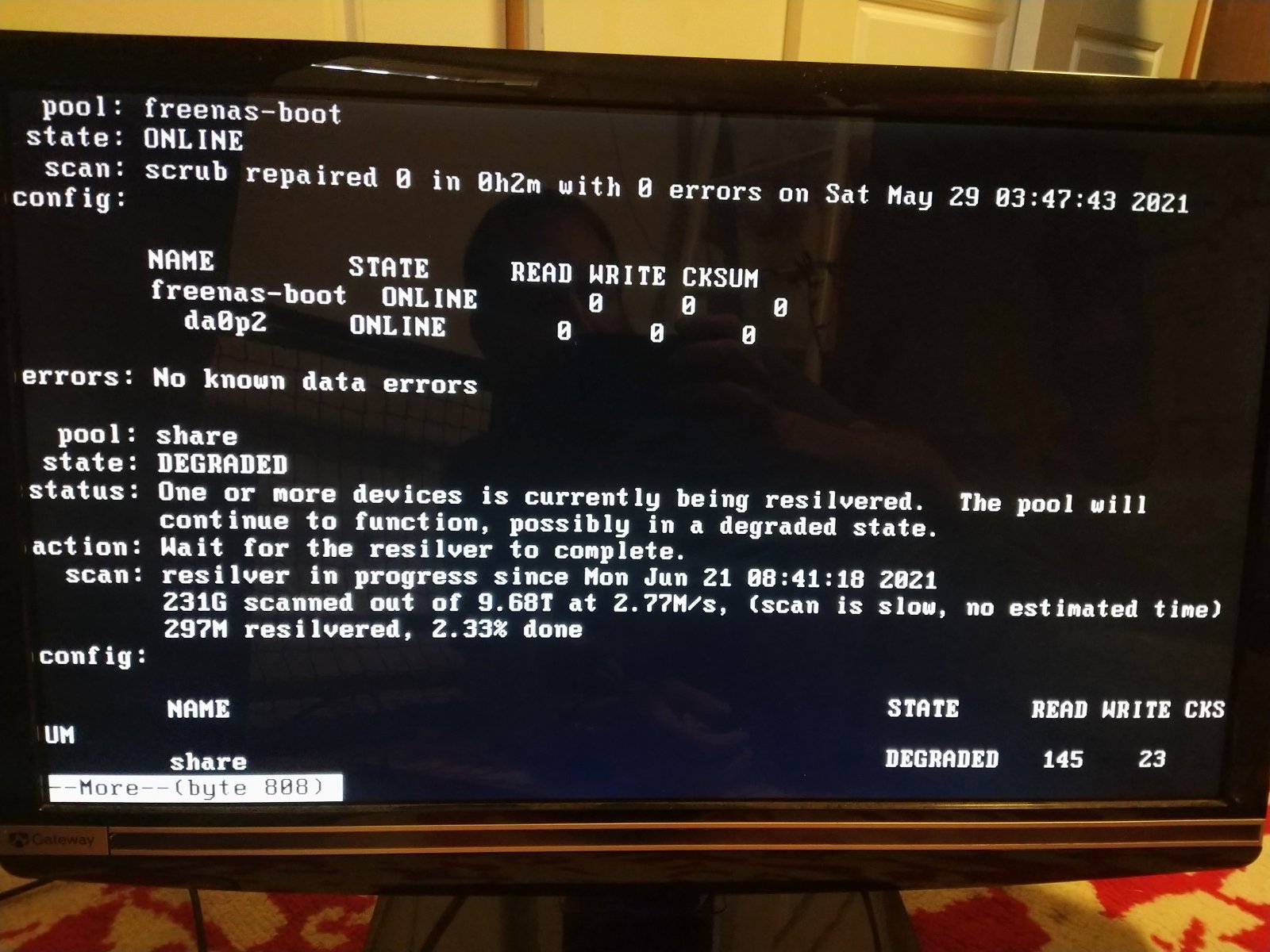

A couple of days ago one of the WD drives failed and I was in the process of replacing it and the sata cable. But suddenly my whole system went AWOL and I don't really know why. My system is now unusable, I can't connect to it remotely because it is extremly slow. When connecting directly to the machine here is the status I get for the pool :

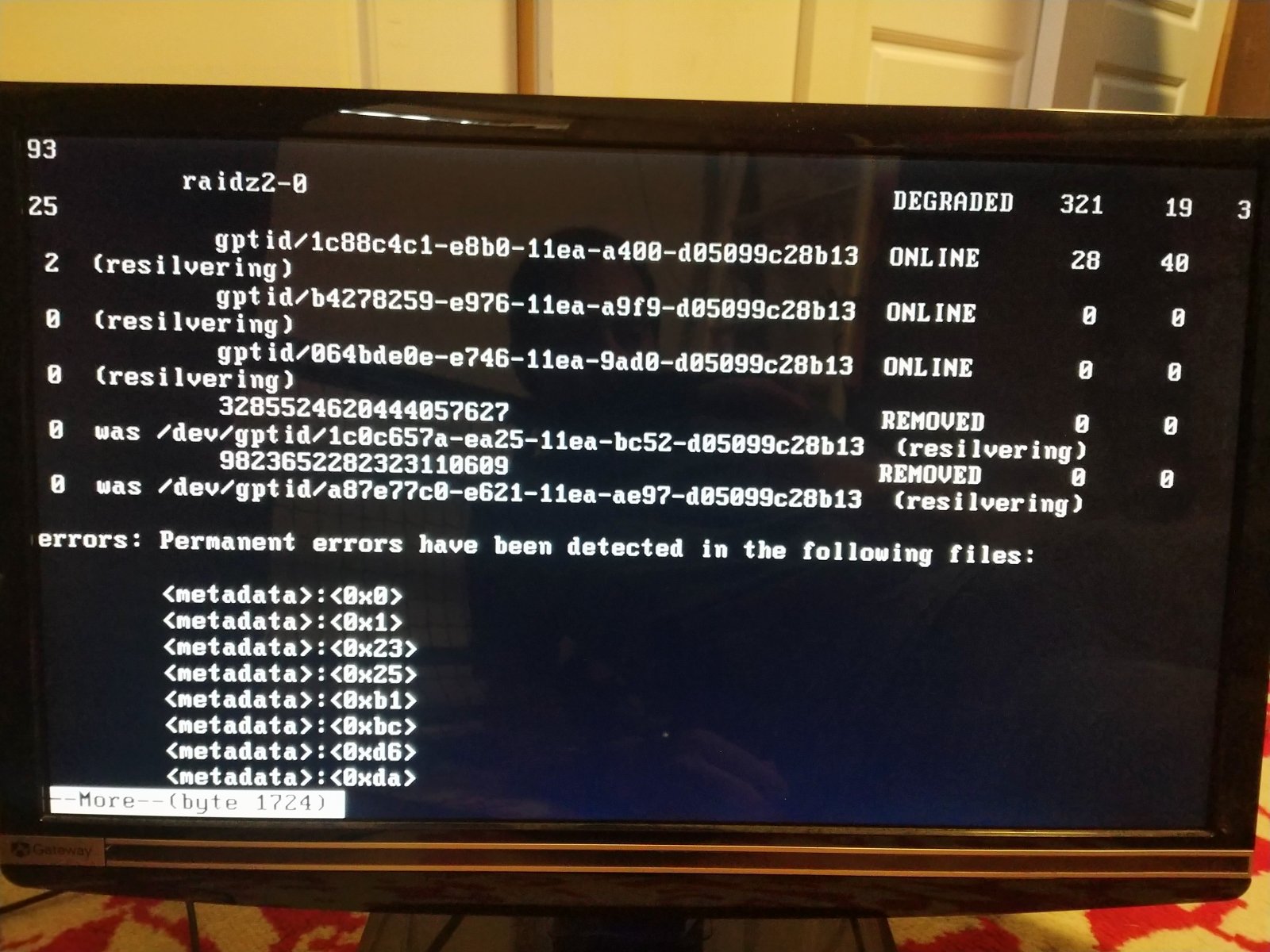

All of a sudden it looks like 2 drives are now dead and resilvering at the same time ? But the resilvering is not doing anything it is stuck at 2.33% since yesterday. I don't really know what to do next or what is most likely failling. My guess is either SATA cables or the ports on the MB, or maybe both but I don't really have another MB to test it out and I don't have 5 cables laying around either.
What would you recommend for me to do ? Can I just unplug the two failling drives and hope to have my NAS back running the time I get replacement parts ? Or should I scrap it all and built a fresh new system (I was looking at the Mini X series the other day...) ? What hope do I have to get my data ? I have recent backups and copies of the most important things but if I can get it back that would be great, even if just to transfer it to another system.
Thanks for your input !

Looks like you lost 2 disks from your RAIDZ2 array... yikes!
So you have two alternatives:
  • Replace both failed disks and resilver
  • Replace one failed disk; resilver; replace the other failed disk; resilver
My hunch is the first choice is the better bet. But in either case: pray!
I've never experienced 2 failed disks in a RAIDZ2 pool, so I can't speak to which alternative is better or safer. Perhaps someone with more experience will chime in.

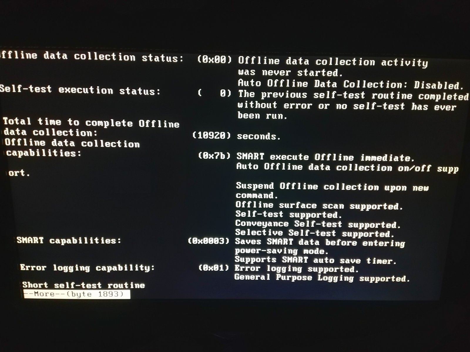

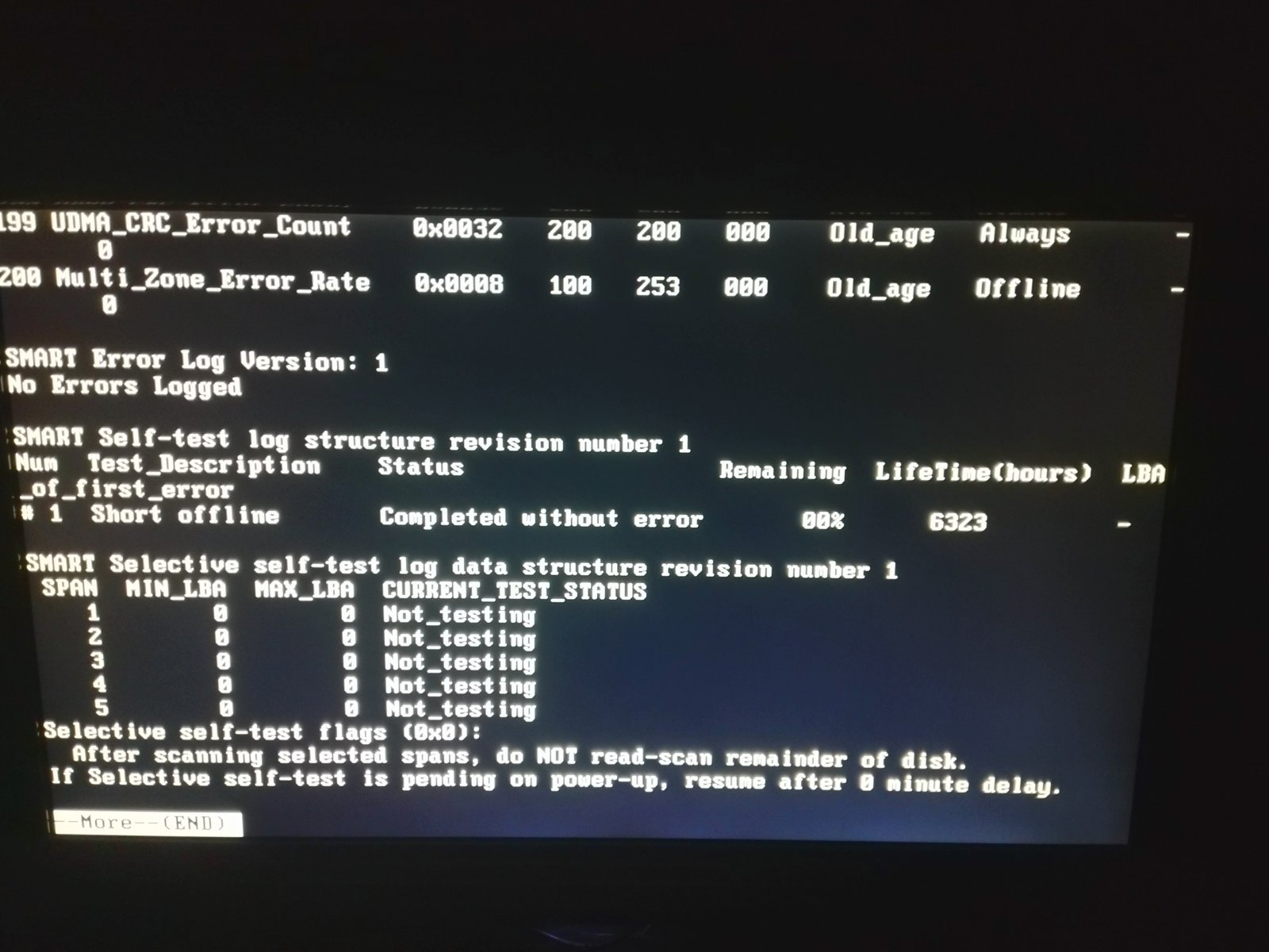

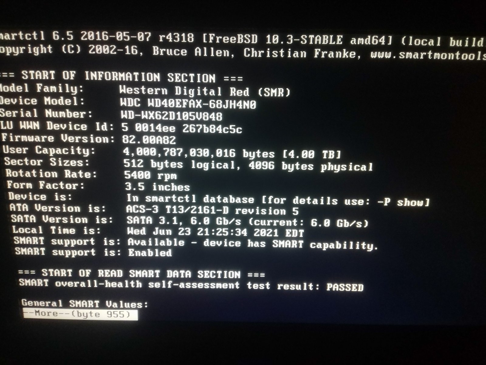

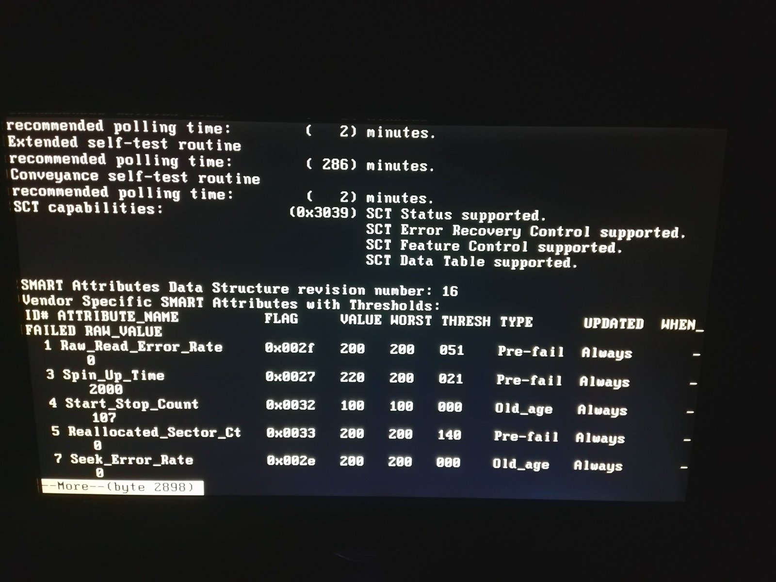

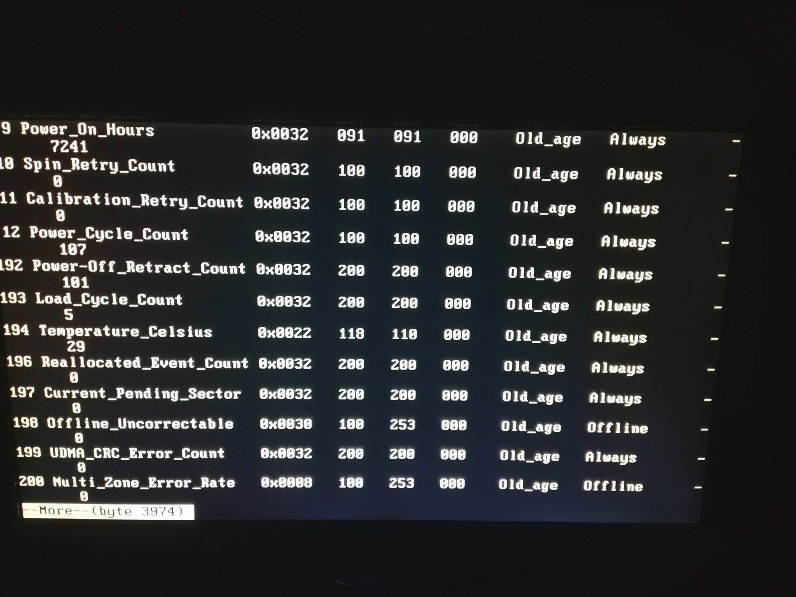

I think it is the case of SMR drives, both failed drives are WD and when I run the smartctl command I get this result (sorry for the pics, I can't connect through ssh) :
IMG_20210623_212540.jpg IMG_20210623_212551.jpg IMG_20210623_212600.jpg IMG_20210623_212607.jpg IMG_20210623_212617.jpg

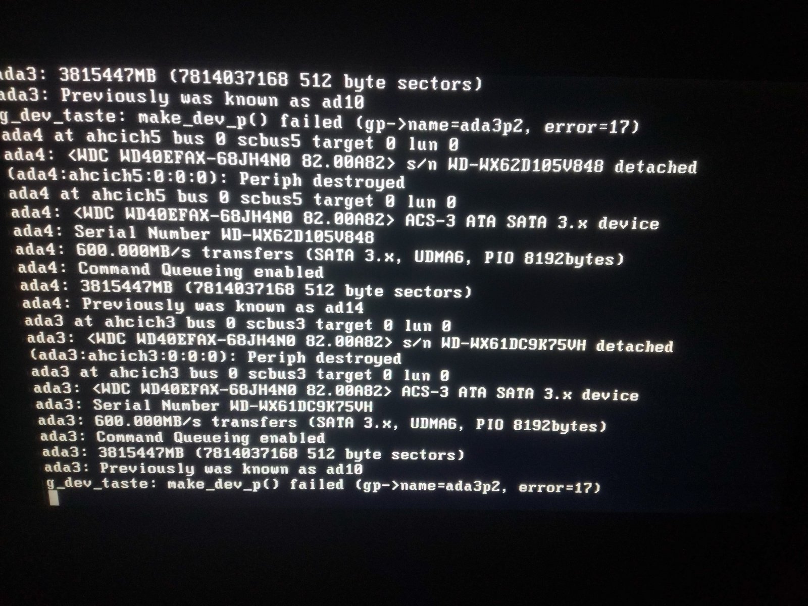

The console also shows lots of messages like these :
I have a spare drive I could throw in to replace one of the failed drives and use a different cable + port on the MB. I just hope this won't kill this brand new drive. Is it ok if I remove both failed drive and only replace one ? Will the resilvering still happen or will ZFS wait to have 5 drives again ?

You have two drives missing, so no redundancy, and then checksum errors on one of you remaining disks. So those sectors have been corrupted.
Often you might've been lucky and just lost files, but it seems you have metadata corruptions.
I suspect you're looking at recreating your pool.
You have a backup right?
FWIW, I'd be trying to restart the box and see if the missing disks come back. If they do everything should come good for the moment.
Etorix
Dec 30, 2020
2,112
All SMR WD drives have to go out; the sooner, the better. Are there more of those than the two failed drives?
There is no reason that it would kill the new drive—except if it's a SMR drive, in which case it should not be used with ZFS.
What's strange is that the drive for which you have provided SMART results (cannot even use the web console?) shows no errors. (But also a single SMART test in his life, one thousand hours ago.)
If you have a backup, restoring it is quickest way out.
If you want to recover this pool, power off the box (possibly take this opportunity to plug in new CMR drives without removing the old ones) and restart, as suggested by @Stux. Replacing with the old drives still in means that you do not lose redundancy—but also that resilvering will take many days.
ZFS can resilver to a vdev which lacks a drive, and will then resilver to a degraded state, waiting for a fifth drive to be added. But replacing all SMR drives in one go would be better.

I also plan on testing all the drives but I don't really know what to look for in the smartctl output. If you could give me just some pointers at what is important to look for, I think that I have 15 or 20 drives to test from previous capacity upgrades and failed drives I could also test and maybe take the good ones to create another backup/replication pool (like most of us I have "some" spare parts laying around....)
Etorix
Dec 30, 2020
2,112
Short answer: Look at SMART IDs 5 and 196-200.
