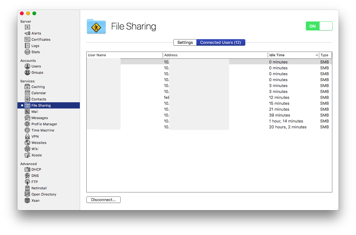

Hi all,
Is it possible to see list of who is connected to an SMB share? And to disconnect (cleanly or forcefully) some/all of the users? I'm considering replacing a macOS Server file sharing box with FreeNAS, and I don't see anything like the attached screenshot.
Thanks,
Sean

from the CLI run smbstatus -b then kill the PID you want shot of

Thanks for your reply, quite helpful. I guess there is no GUI for this? Not too important, the -b status output is useful enough.
But killing the process does not seem to cause a disconnection of the client. I am connected from macOS, then kill the associated pid, but I'm still able to navigate into folders from the Finder. Running smbstatus again just shows a new pid associated.

Small follow up: killing the process is still useful when changing share settings at least. The client may reconnect quickly, but at least then it sees things like permission changes.
