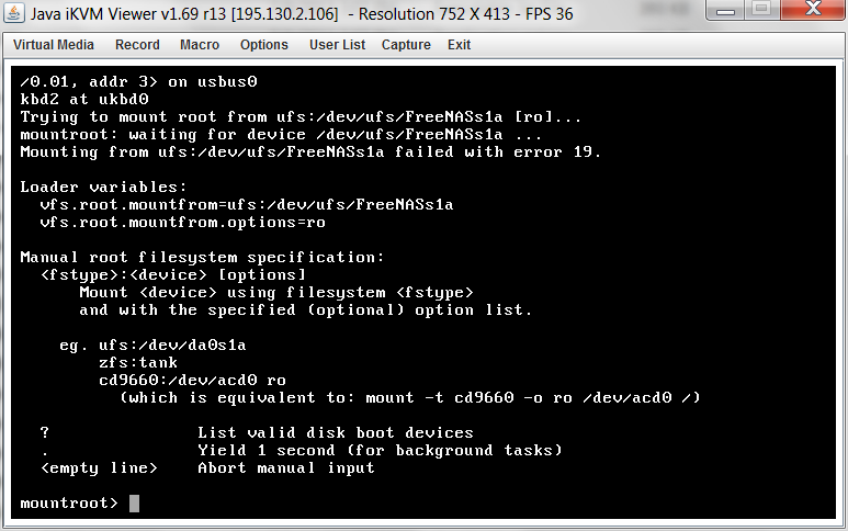

I have a SuperMicro X8SIL-F and I tried installing freenas through IPMI on two different HDs to try and trouble shoot and I keep coming up with the same problem. The entire install went fine until the reboot I cant seem to get an internal IP address to get assigned so that I can log into the GUI. Here's a screenshot of where things stop and I need a little guidance to figure this out.

Don't install FreeNAS on a hard drive. Burn the image to a USB stick and boot from that. You'll find the docs at doc.freenas.org.

Thanks for the info. I have a couple very small SSDs that I would like to put back to use and strangely enough I don't have a USB stick. I can get the install working on a cd install from my test machine I just wanted to try this without an installed CDROM with this board

I have mine installed to USB stick and still getting
I have mine installed to a USB stick but I get the same problem once in a while after reboots.
Freenas 9.2
Supermicro motherboard X10SLH-F

If you're getting the error in that image, burn the image to a different stick.
