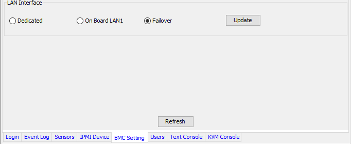

My BMC setting shown in the IPMIView as below.
ipmicfg in my esxi to confirm that the lan mode is failover.

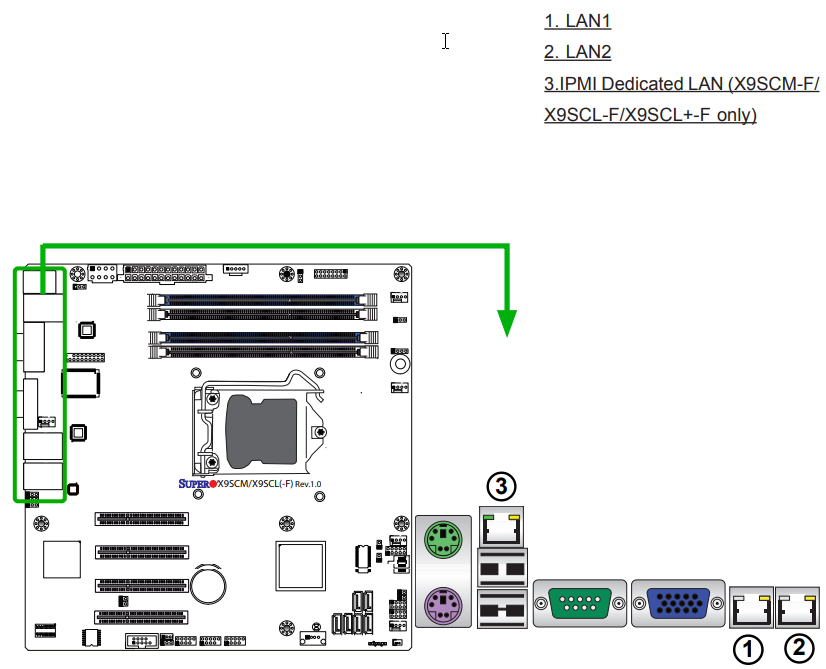

I am not able to failover to the port which is closest to the VGA port.
When I unplugged the dedicated ipmi cable, the ipmi view is not able to find out any IP working in the lan.

I have a X9SCL-F which is similar to yours. Try the port that is directly above the IPMI port instead of using LAN1. On my board, the one above the USB ports is LAN1 and the two LAN ports directly above each other are LAN2 on top and IPMI on the bottom.
Thanks inxsible
according to the manual: MNL-1270.pdf
I cannot failover from 3.IPMI Dedicated LAN to 1. LAN1.

In this instance, I don't think "fail-over" means what you think it means. If there is no network connection on the port you have labeled 3, when the unit is energized, it will attempt an IPMI connection on the port you have labeled 1. It will not switch from one to the other while the system is working.
