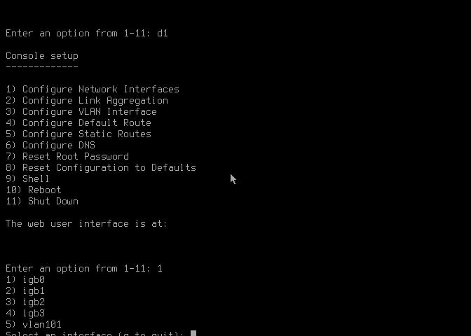

Did you try it on the physical console to change the IP address from igb0 to igb1?
[Edit] Chose option 1 on the physical console and then select the interface you would like to use (e.g., igb1)

I just tried changing the interface to igb1 (running /etc/netcli from the physical console) and switching the cable over but no luck. I also tried to reboot, and I can see that dhclient is only trying to acquire an IP address for igb0.
When running ifconfig after reboot, I can see the cable is plugged to the correct port but no IP address is assigned:
igb0: flags=8c02<BROADCAST,OACTIVE,SIMPLEX,MULTICAST> metric 0 mtu 1500
    options=6403bb<RXCSUM,TXCSUM,VLAN_MTU,VLAN_HWTAGGING,JUMBO_MTU,VLAN_HWCSUM,TSO4,TSO6,VLAN_HWTSO,RXCSUM_IPV6,TXCSUM_IPV6>
    media: Ethernet autoselect
    status: no carrier
igb1: flags=8843<UP,BROADCAST,RUNNING,SIMPLEX,MULTICAST> metric 0 mtu 1500
    media: Ethernet autoselect (1000baseT <full-duplex>)
    status: active
Ok, so I tried to run /etc/netcli again. This time I first selected option 1) Configure Network Interfaces and then chose igb0. This gave me the option to delete the config for that interface to which I replied "yes, please". After that I selected option 1) Configure Network Interfaces again and this time selected interface igb1.
Still there was no IP address for interface igb1. So now I ran dhclient igb1 and then I had an IP address for igb1.
Now, I can log in to the web console.
Looking at the “Network > Interfaces” there are no longer any interfaces configured (good), so now I can add the igb1 interface, set it to DHCP and IPv6 Auto Configure.
Now, I will try a reboot and see if it persists.
Edit:
After reboot the system is working fine and using the igb1 interface. :)
