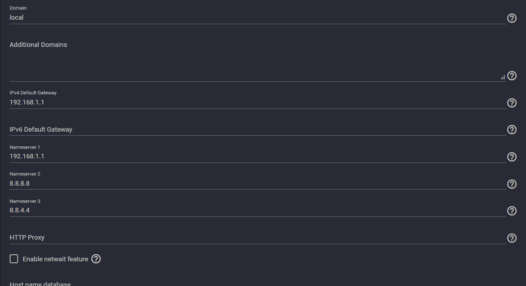

I've experimented with settings that were mentioned in other posts, most notably setting the gateway and DNS addresses. Which were in place from when it was working before, but I've tried fiddling around with some different nameserver IPs and other things from some posts I was reading, with no luck. Current settings are back to what I had plugged in previously, which worked before:

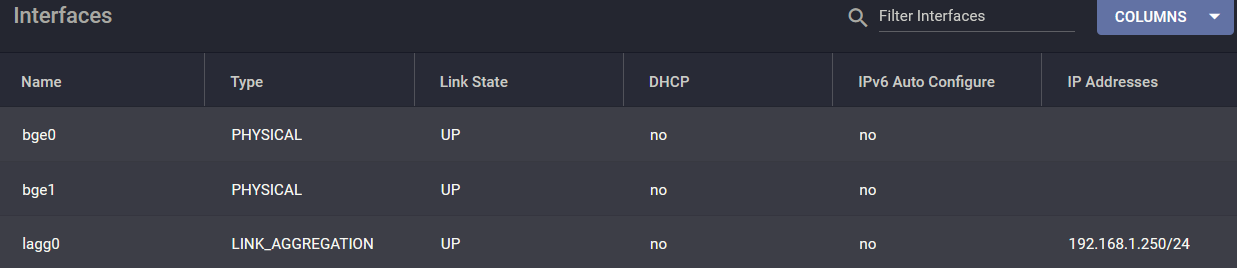

I have a LAGG set up here - it's a gen8 microserver with dual ports.

Would completely tearing down the lagg and redoing it again help? I've never had my internet access "lose it's way" like this before, so sort of unsure of where to start.
