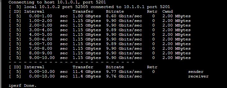

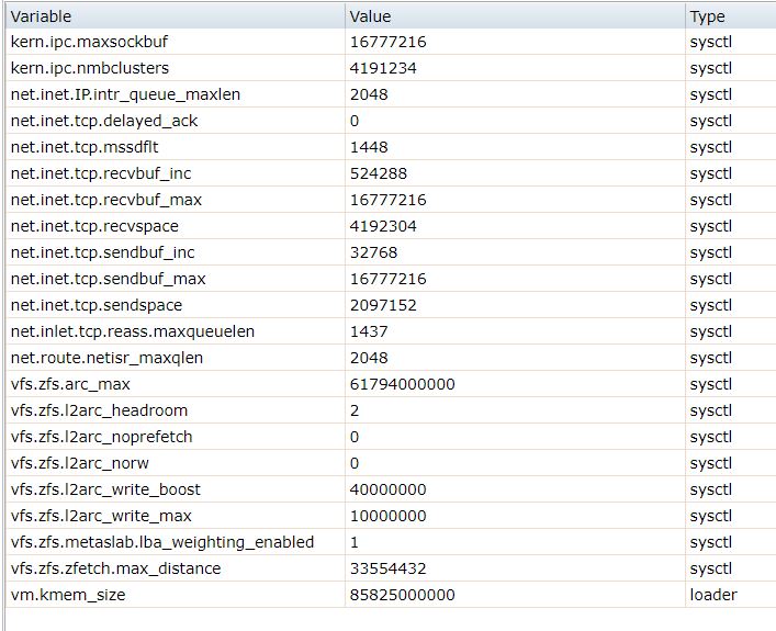

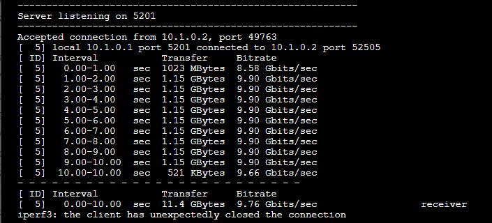

It didn't make sense to me either. But for some reason it made a huge difference. Here are all the tests i ran.
