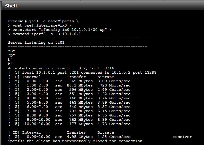

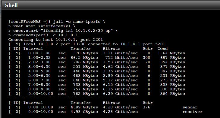

I had some help but i ran iperf with both ports connected to each other and this is what i ended up with.
As you'll see even the card is not spitting out full speed between the ports

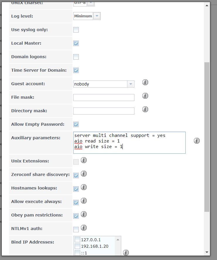

First things first lets make sure that smb multichannel is on. And how do i turn it on
oumpa31
Apr 7, 2015
253
i think i turned it on
but it doesn't have the option for server maximum protocol
