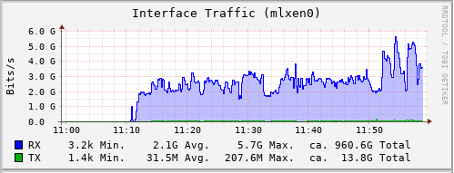

I think I have this figured out. I started to watch the CPU util in top, and when compression is enabled its pinned at 100%.
The attached photo has a little bump and then a big bump. The little one is with compression turned on.
The compression process looks to have been my bottleneck. My little 2.4GHz CPU's just couldn't keep up with the workload.
I will report back with results when I have more to share

Donny Davis
Jul 31, 2015
139
rsync performance is still not very good at all (same as before), but at least ZFS replication is. This is a large improvement for me.
To be honest I see modest savings in the compression dept, so this is not a loss for me really. I have 150TB of usable space, and not 150TB of requirements.
Donny Davis
Jul 31, 2015
139
The top nic is coming from my oVirt deployment, the bottom from my replication. I think this thread can be marked as solved(ish). I will open a new thread in the right forum if I have more issues.
For now I can't expect 1GB writes and reads over the network without spending more time testing and tuning.
Thanks for your help @jgreco @Nick2253 @SweetAndLow

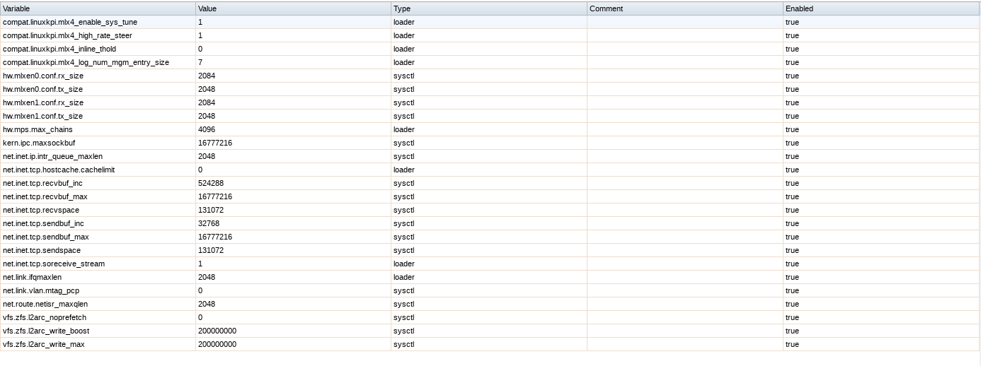

With a real workload copying virtual disks from one server to another using oVirt, I am getting the performance I would expect to see. It did require some tuning, but I am a happy camper.
I am marking this thread solved.

Donny Davis
Jul 31, 2015
