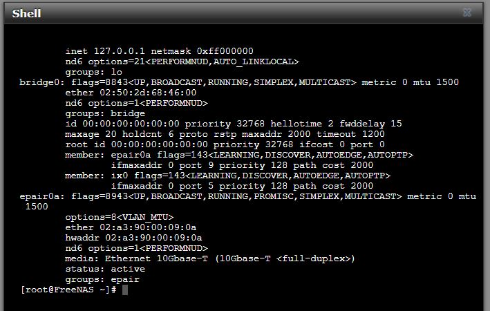

Sorry forgot to put that. I'm running 11.1

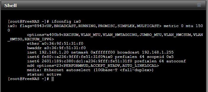

this is all i was able to get from my ifconfig in shell. i'm not exzactly sure how to scroll up to get the whole thing.

We need the exact version (eg U4, U6, something else?) plus the full output (the important stuff was at the top).

Run:
ifconfig -a | more
or
ifconfig ix0
since it appears you have an "ix" type ethernet device.

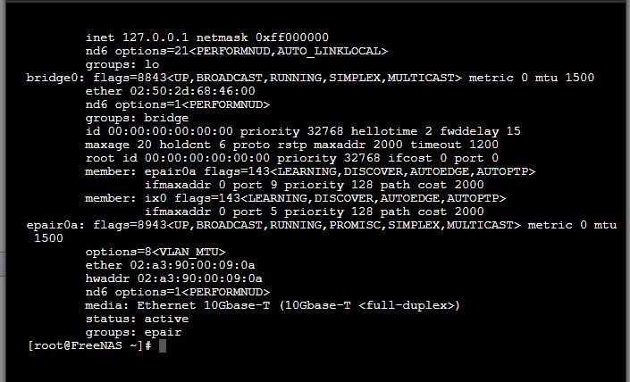

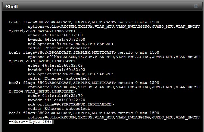

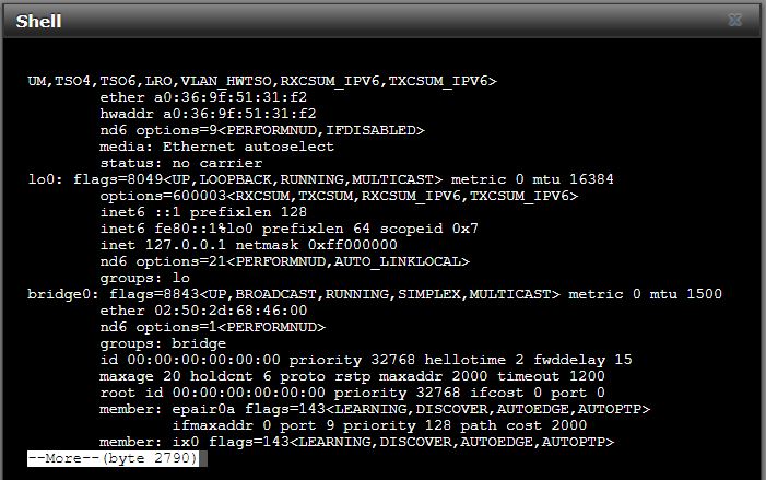

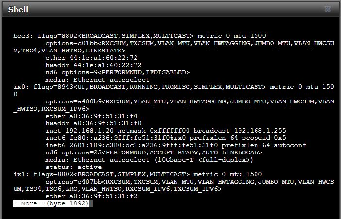

Sorry for the long wait i had to get home from work. It is version U6 stable. I've just recently fully come over to the freeNAS side. I had played with it back in the day with an old p4 but until now i didn't have the means to switch fully over. So im still learning unfortunately. but i do read this forum a lot now. And before you ask this is in a striped array. i have a second NAS in a raid 5 as my back up that has spinning rust wd red drives.

I think Dru wanted to confirm that your link was negotiated at 10Gbps and not something slower.

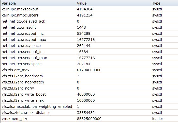

There are a bunch of tunables that can be tweaked. A previous round of discussion resulted in a suggestion of
kern.ipc.maxsockbuf: 16777216
net.inet.ip.intr_queue_maxlen: 2048
net.inet.tcp.recvbuf_inc: 524288
net.inet.tcp.recvbuf_max: 16777216
net.inet.tcp.recvspace: 4192304
net.inet.tcp.sendbuf_inc: 32768
net.inet.tcp.sendbuf_max: 16777216
net.inet.tcp.sendspace: 2097152
net.route.netisr_maxqlen: 2048
but those might not be the most up-to-date. But good search-box fodder.

So these are the tunables and the current settings running the iperf for 100 seconds the max speed is 364MBps.
I'll try and change some of those and see where I'm at. Some of the ones you posted are not located on this.

I tested each one and i never got over 275. not really sure what the problem is. i tested with all the settings at the numbers that were suggested but nothing changed or it got worse. :/
So in your ifconfig output, for ix0, the interface is showing in promiscuous mode. Are you running something that's doing packet capture? Or do you have VMs configured? At least for testing purposes you might want to disable any of that stuff and get the card out of promiscuous mode. Notably, tcp segmentation offload and some other performance enhancements appear to be disabled on the interface when it's in promiscuous mode. That could be the source of some of your issues.
Also, this may be a dumb question, but you did reboot after you set all the kernel tunables, but before you tested, correct?
A few comments on the tunables:
net.inet.tcp.recvspace (and sendspace) seem small. we typically use 4194304.
Most of the zfs tunables in your list are better left at their defaults. The zfs.arc parameters are largely ignored by the most recent versions of ZFS and most of that code is self tuning and better left at the defaults. In any event, based on your hardware config, none of those ZFS tunables will make a measurable difference on your read and write speeds.
