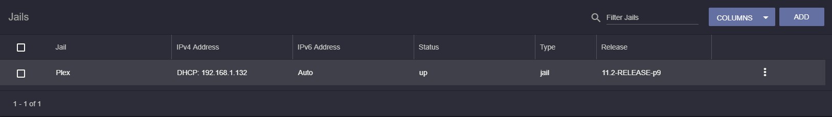

if you type
jls
in the main shell can you see the jails you've created?
BamBamm
Aug 30, 2015
207
Yes, it does show up.

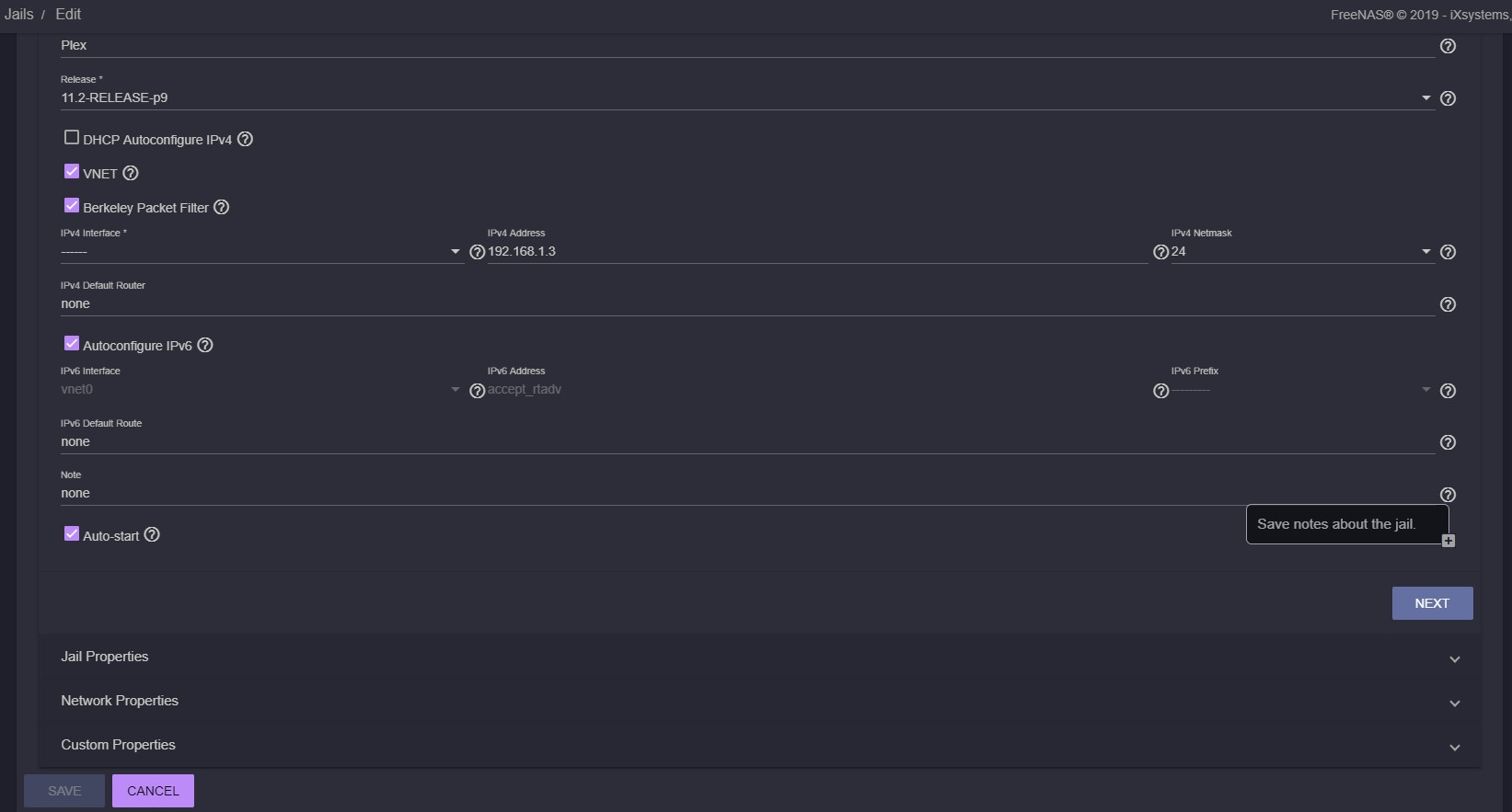

Go back to your jail main tab and click edit. you need to assign it an IPv4 address

This IP needs to be static it's how you'll log into your PLEX webserver.

So, stop the jail, click edit, then what?
Can I just type any number I want after the 192.168.1.?
My old Plex address was 192.168.1.3
Velcade
Mar 28, 2019
108
Yes; you can change it to whatever you'd like.
BamBamm
Aug 30, 2015
207
IPv4 Mask?
Auto Run?
Velcade
Mar 28, 2019
108
DHCP: unchecked
IPv4 address: 192.168.1.3
Ipv4 NetMask: 255.255.255.0 (24)
default netmask for most home routers.
auto run is up to you, if you'd like this jail to start automatically when the system starts up or if you want to enable it manually.

It won't allow me to save. The "Save" button is greyed out.
Velcade
Mar 28, 2019
108
You need to assign your IPv4 interface. You should also assign your default router (your router's IP).

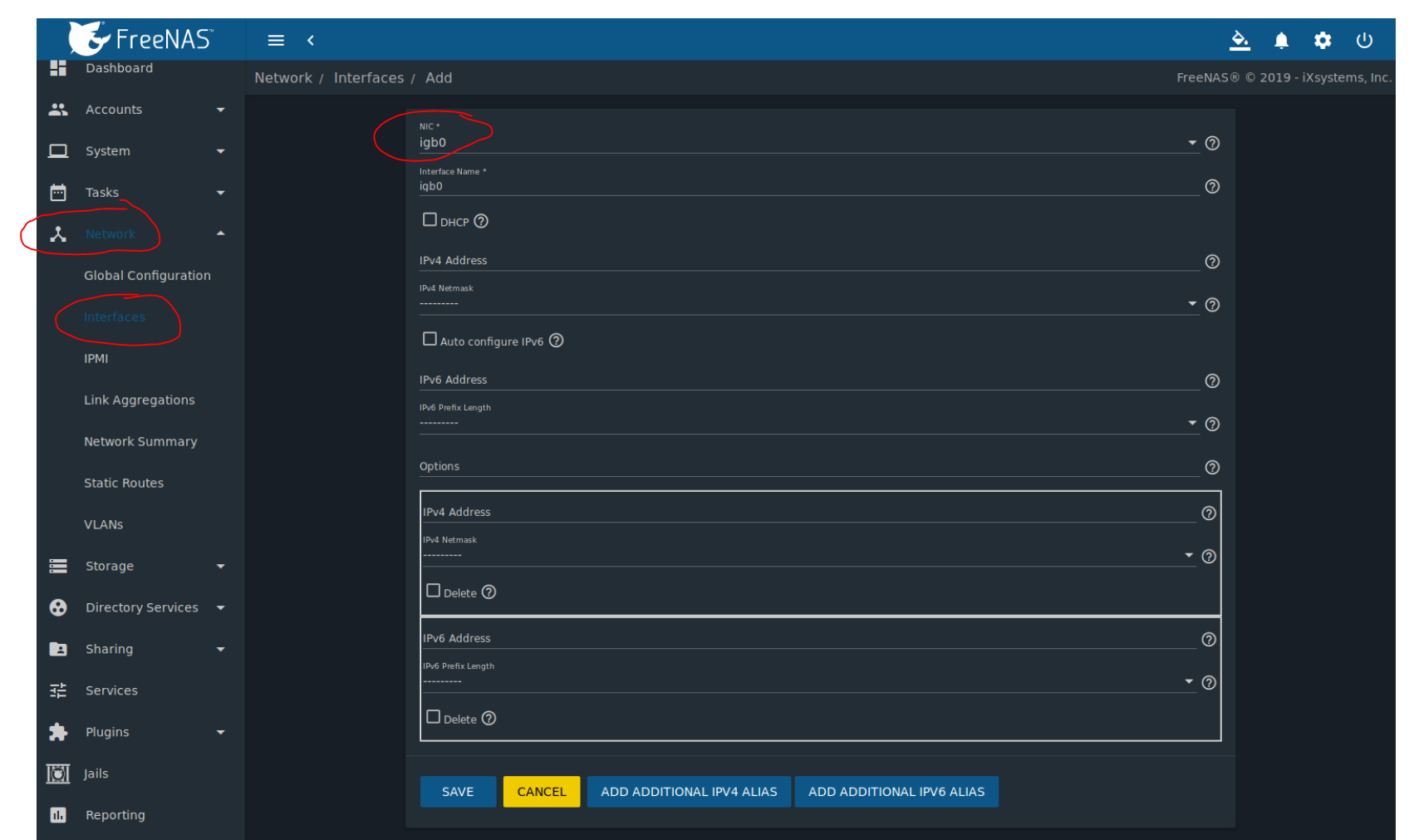

What interface is your FreeNAS using? Network > Interfaces > NIC
Use that

Are you sure you went Network > Interfaces > NIC
BamBamm
Aug 30, 2015
207
Yes...
I just created one.
Velcade
Mar 28, 2019
108
It should have been created when you first installed FreeNAS. How is your system running if there isn't an interface assigned to it?
