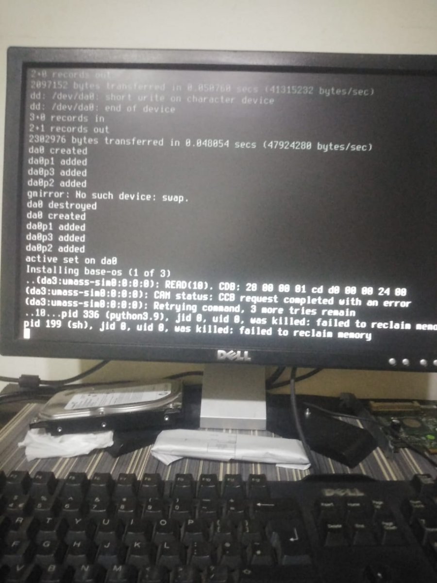

Hello, I'd like to make use of my older server (Dell PowerEdge 840) with 8GB RAM (the maximum supported), a Core 2 Quad processor, 1 SAS drive for TrueNAS installation, and 2 1TB SAS drives for the storage pool. However, I'm encountering an error that says "Failed to claim the memory." Sometimes the installation progress reaches 10%, and at other times, it reaches 50% before abruptly stopping due to a memory claim problem. I would appreciate your assistance in resolving this issue.

You're having read errors on da3 which seems to be a USB device (maybe the install media).
Try a different device as that one seems no good.

In your screenshot, da3 is showing up as UMASS (USB Mass Storage).
What boot disk are you using to install to?

"Amount of Available Memory limited to 256MB !
Strike the F1 Key to continue, F2 to run the setup utility"
"going into BIOS, disable OS Install Mode."
