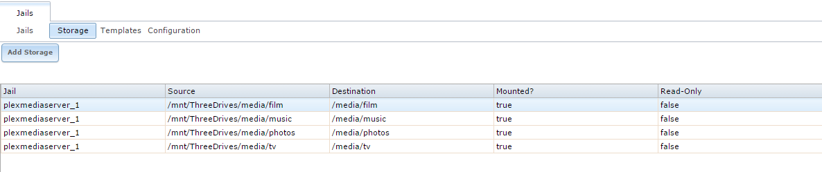

I also don't have any Storage attached to that jail, should I go through and attach my current (well, original before I had to fresh install the boot drive) 'mnt/media/tv' to 'media/tv', 'mnt/media/film' etc ?

The plugin seems to have installed correctly, if I login via plex.tv I can see my films, music etc, but nothing plays. Also if I go directly to the IP address that doesn't work either. Is this something to do with the storage not being assigned with the jail?

Haha! Fixed, thank you @Joshua Parker Ruehlig
For anyone coming to this for the answer here's a summary.
- My USB Stick with my boot drive failed, I didn't download a config (didn't know you could), schoolboy error. A fresh install and I've got my old drives and datasets, as well as my old jail for Plex.
- You can't install plex via the plugins page as it'll create a new jail so you have to go to your existing jail, click the the little box to upload a plugin.
- I found the PBI file by downloading it from http://download.freenas.org/plugins/9/x64/
- This bit is potentially tricky, I then had to recreate my storage attachments, in my case 'tv', 'film', 'photos' and 'music'. Luckily I didn't do anything more complicated than call them the same on both. (as per screenshot)
- Then just make sure they're mounted and plex should pick up where you left off.
