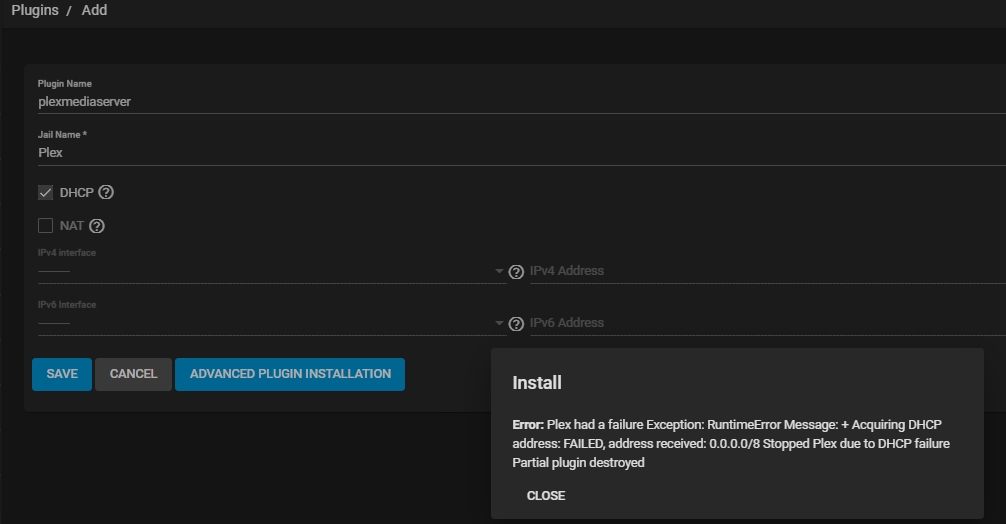

Im running TrueNAS 12 on a Hyper-V on my computer. I want to run a Plex server but I cant install any plugin at all.. I get this error. I have tried to search on Google to find a solution, but no luck so far.
Can anyone help me here?
Error: Plex had a failure Exception: RuntimeError Message: + Acquiring DHCP address: FAILED, address received: 0.0.0.0/8 Stopped Plex due to DHCP failure Partial plugin destroyed

Having the same problems here Lasse1981, did you found solution for this? anybody?

Hyper-V is known to be not-compatible with TrueNAS. Please read the virtualization stickies, especially
