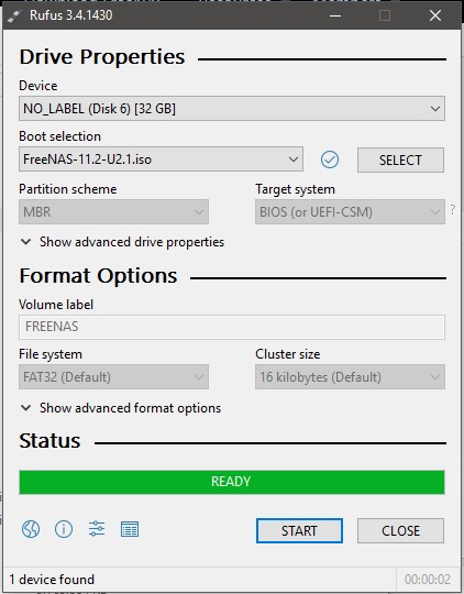

rebuilt the usb stick (MBR this time) still no luck

See if it boots up using FreeNAS 11.1-U7. There are some posts around problems with booting 11.2. I'm running an N40L successfully on 11.1. I'm not yet ready to move it to 11.2 on that system so I haven't yet come up against the problem you're seeing. I am running 11.2 successfully on its elder brothers, a pair of N54L's.
YES that did the trick, 11.1 installed without issue and now up n running
