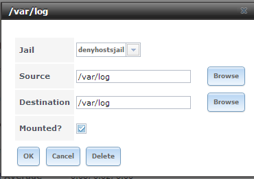

  1. Create a jail applicable for non-pbi software from the WebGUI. An ip shouldn't be required for this setup (unless synch bad hosts required).. Ensure jail startup is automatic..
  2. Still within the GUI create a mount storage point for the jail .. /var/log/ (freenas usb) >>> /var/newlogmount (new denyhosts jail - see image below) ** See Corection Here..

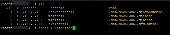

3. Using putty(recommended) or the WebGUI shell enter/access into the jail..
4. Review installing non-pbi software. Within the Jail - Install DenyHosts via Freshports with the pkg install command.

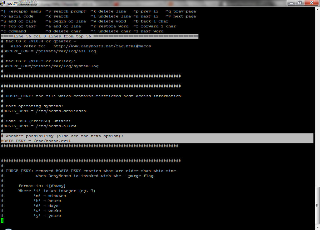

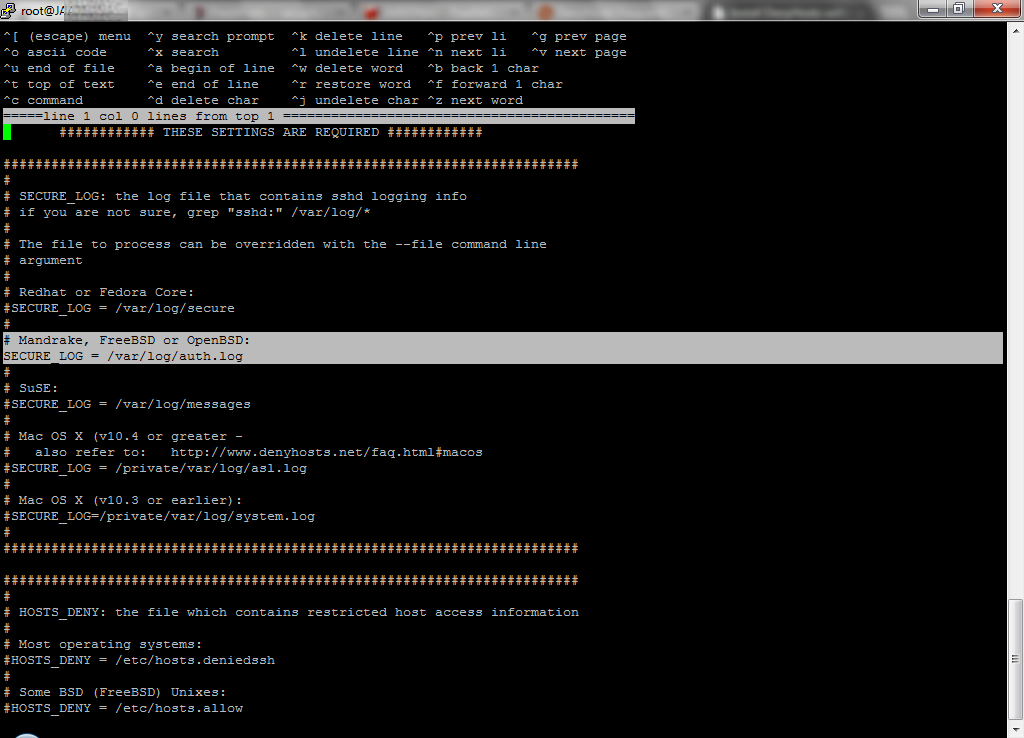

5.From within the newly crated jail - access the DenyHosts configuration and uncomment the appropriate lines for FreeBSD.. You may have to comment-out the linux specific lines..
SECURE LOG
HOSTS_DENY: the file which contains restricted host access information
HOSTS_DENY = /etc/hosts.evil
** output to new file (hosts.evil) instead of hosts.allow for freebsd and/or linux setup equivalent ..

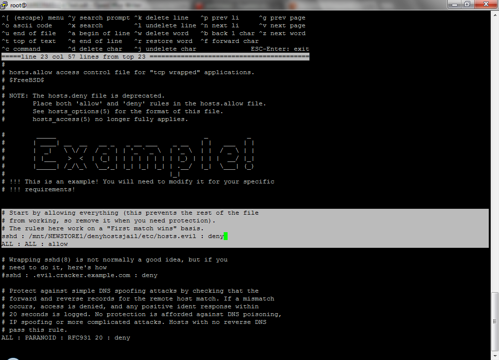

6. Exit the jail using "exit" command. Within base freenas install edit /etc/hosts.allow with the following to instruct ssd to check the hosts.evil file before allowing all other connections.. Find the ALL : ALL : allow (Note full path) and place your deny instruction above.. See below..
sshd : /mnt/NEWSTORE1/denyhostsjail/etc/hosts.evil : deny
ALL : ALL : allow
Save the new hosts.allow and restart SSH..

  1. Create a jail applicable for non-pbi software from the WebGUI. An ip shouldn't be required for this setup.. Ensure jail startup is automatic..
  2. Still within the GUI create a mount storage point for the jail .. /var/log/ (freenas usb) >>> /var/log (new denyhosts jail - see image below)
I don't think this is a good idea. There is a syslogd running inside the jail that is configured to use /var/log. By mounting the FreeNAS /var/log over the jail /var/log you have two syslogds (the FreeNAS one and the jail one) trying to write into the same set of files.
cyberjock
Inactive Account
Mar 25, 2012
19,526
I agree.
Yatti420
Neophyte Sage
Aug 12, 2012
1,437
I knew this would be a point of contention.. I will re-do the setup shortly changing that directory.. It still works and doesn't appear to be consequences for now.. If the syslog in the jail did write into host var log it would overwrite I assume? I didn't think jail software etc could talk to the host system.. This may be a bigger issue if the logs cycle (can't recreate proper log in proper location?).. I do notice a log appearing on host /var/log/denyhosts - If its magically being written on the USB I can see this becoming a problem with space remaining.. I realize syslog runs in jails is it really required?
Dusan
Neophyte Sage
Jan 29, 2013
1,165
The only limit to what a jailed process can do in a mounted storage point are the file system permissions (e.g. if the process runs as root, it can do anything). This is how most people run Transmission. Transmission runs in a jail, but the downloaded files are saved "outside" the jail.
You mounted the host's /var/log in the jail, so whatever you do in the jail also appears outside the jail -- it's the same "physical" location accessed by both the host and the jail. Also, that's not USB, /var is a 150MB ramdisk (/dev/md2).
It's not 100% necessary, but if you stop it you lose any logging in the jail.

Ok.. I am going to amend the writeup to change the mount point to a new directory as is good practice.. For simplicity and correct operation this advice should be respected.. Step #2 would be amended to something like /var/log/ (freenas usb) >>> /newlogs/ or /var/newlogs/ etc..
All my logs are successfully captured and seperated oddly.. I send them all to a new jail setup to capture syslog reports using minirsyslogd..I do notice all the files in /var/log/ like its now a "single" mount point..
Edit varlogmnt folder created in root directory of jail and mounted per step 2.. This should resolve any issues..
# SECURE_LOG: the log file that contains sshd logging info
# if you are not sure, grep "sshd:" /var/log/*
# The file to process can be overridden with the --file com
# argument
# Redhat or Fedora Core:
#SECURE_LOG = /var/log/secure
# Mandrake, FreeBSD or OpenBSD:
SECURE_LOG = /varlogmnt/auth.log
# SuSE:
#SECURE_LOG = /var/log/messages
