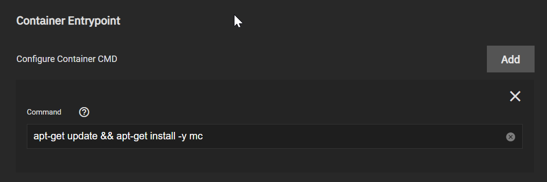

In the shell I can install other software - but I like a solution that install the software at re-creation.
I'm looking in the cmd part - but can't find the correkt syntax

9,700
What you (both) need to do is learn how to create a docker image using something like docker build... I'm sure some googling will turn up thousands of how-tos.
You can create your dockerfile (for use with docker build) in github and then use docker hub to build that or you can build it locally and use docker push (after tagging the image to name it) to upload it to the docker registry (or a private one of your own).
You can base your image (at the start of the dockerfile) on the one you're already using and just add the bits you want in the container.

9,700
So you could present a host path to the container and have a script in that which carries out your install commands, then refer to that on the CMD... making sure to end that script with whatever the container normally would execute.

But in general, regardless of SCALE or Unraid or whatever, you cannot persistently install random software into most containers unless the container creator took that into account. It's simply not what containers are for.
So in all of those cases, if you need container modification you would've to... modify the container.
or override the starting command like @sretalla explained, if that's supported on the App in question.
