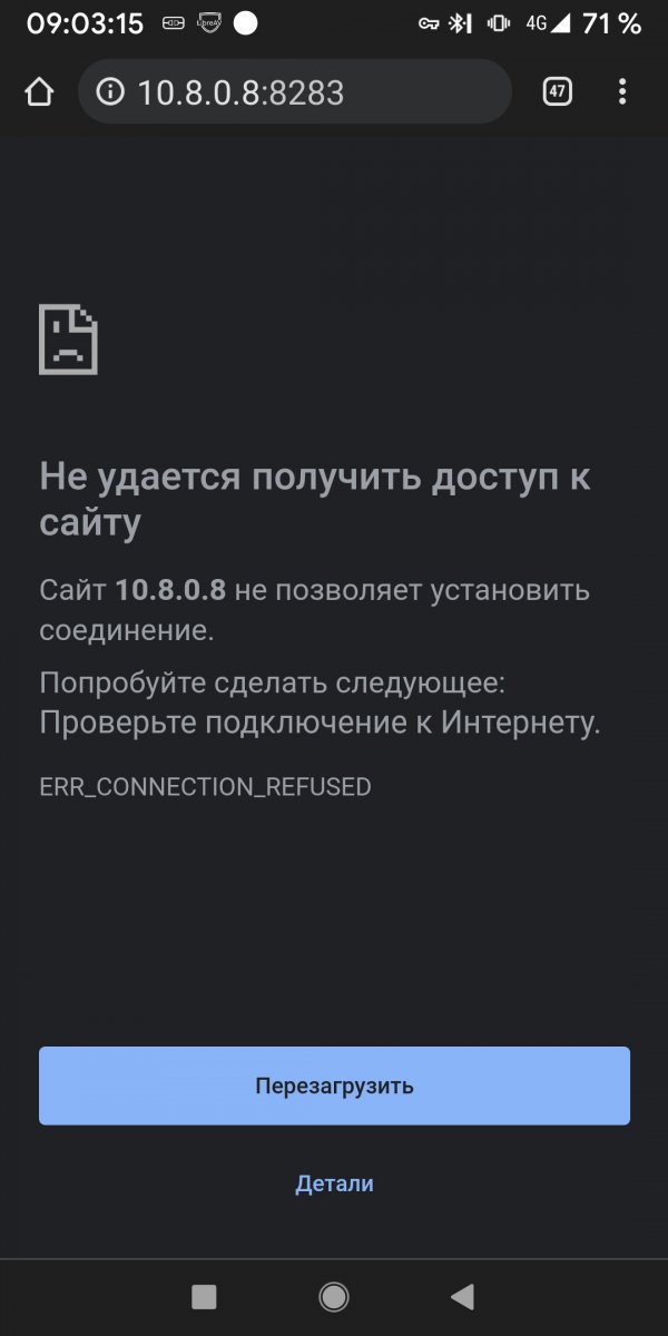

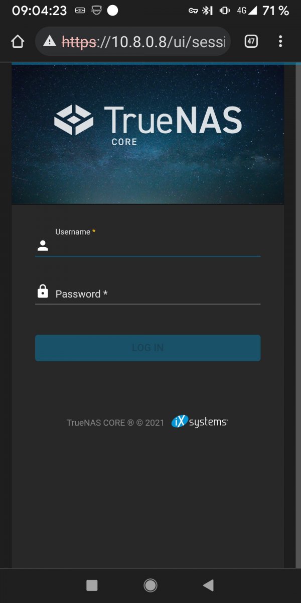

The fact is that I already have access to the host via open vpn and I need to configure access in jail. A working solution is to install the open vpn client in the same jail as nextcloud. But I just cannot understand why it is impossible to configure access to jail via vpn from the host. Why is there access without vpn in the local network, but via vpn there is only access to the host. Open Vpn is configured on the host.
Is the default gateway of your jail set correctly?
Everything was correct. The VPN client that is installed on trunas does not provide access to the prison that is installed on the same trunas. If you succeed, please share. The TRUNAS operating system differs from pure Fribsd in that many “dangerous” features are removed from it.
