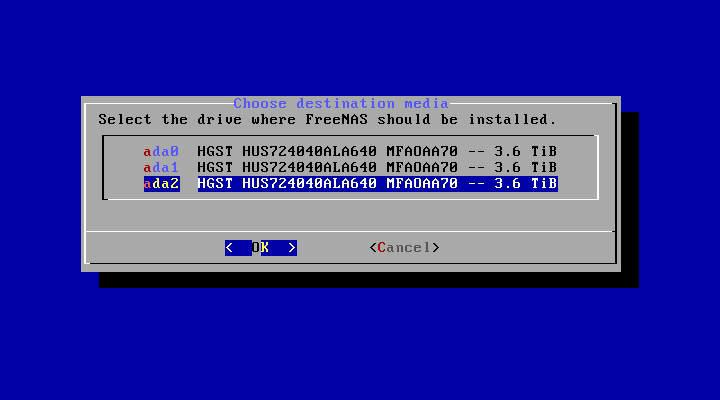

I take a screenshot of the KVM screen. I can see only 3 drives even if I press the down arrow key.

Sorry, the up/down arrow key thing was for the 9.3 installation.
I would say the issue is still in the BIOS and you need to tell it to treat the USB as a hard drive. Also, ensure you are not plugged into a USB 3.0 connection (blue connector) as this can cause issues as well.

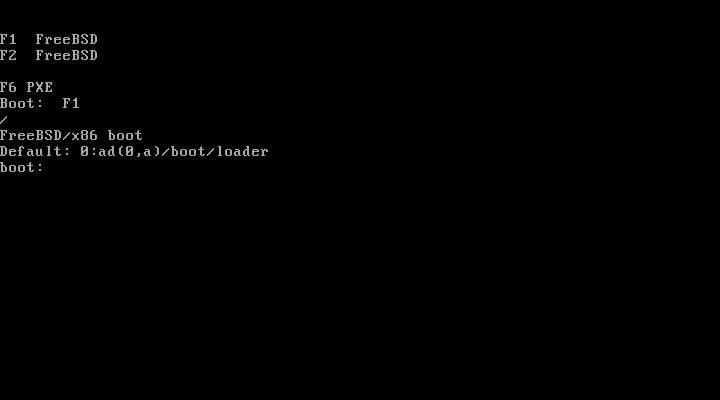

I have another issue, the FreeNAS installation on the HDD enter in conflict with the new FreeNAS installation on the USB drive, the server boot from the HDD #3 even if in the Bios the boot device is the USB drive.
If I press F2 I got what you can see in the screenshot.
Need more help please.

During the power on sequence of the computer, many systems will let you hit F12 (in my case) to pull up a list of devices to boot from. Not sure if this is an option for you. Also, even if you get that done you will still need to change the boot order in the BIOS or you will likely see a message stating you cannot boot from the data drive.
EDIT: One other option if you cannot get this to work... Bring someone else into the picture that could remote into the server and make it work. I'd of course change my password and stuff to something temporary and use that. I'd offer but I'm leaving on work travel today and will be gone for the week. I'll still check the forums but I won't have time to assist in that capacity, not this week if it's something that might help you out.
