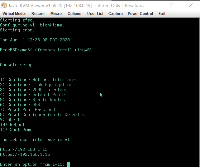

I am having some issues connecting to the web user interface - I configured the network interface following some guides and it gives me a web address afterwards, but the addresses don't work. I have restarted and the same issue

In the console setup, I hit 1 to configure network interface. That is the only thing I have done.
It saves the interface configuration and restarts network and says failed - then it displays the console setup again and below that tells me that the web user interface is at : http://192.168.0.108 but the address doesn't work
Sorry, I didn't know I could post images. Here is a picture
Are you talking about #4, setting a default route?
Looks like when I set up the default route and tried going to the shell and pinging a random site, it tells me there is a host name lookup failure

You also have to set DNS servers.

Dumb question, how do I know what to put in that section? The guide says not to use what he is using

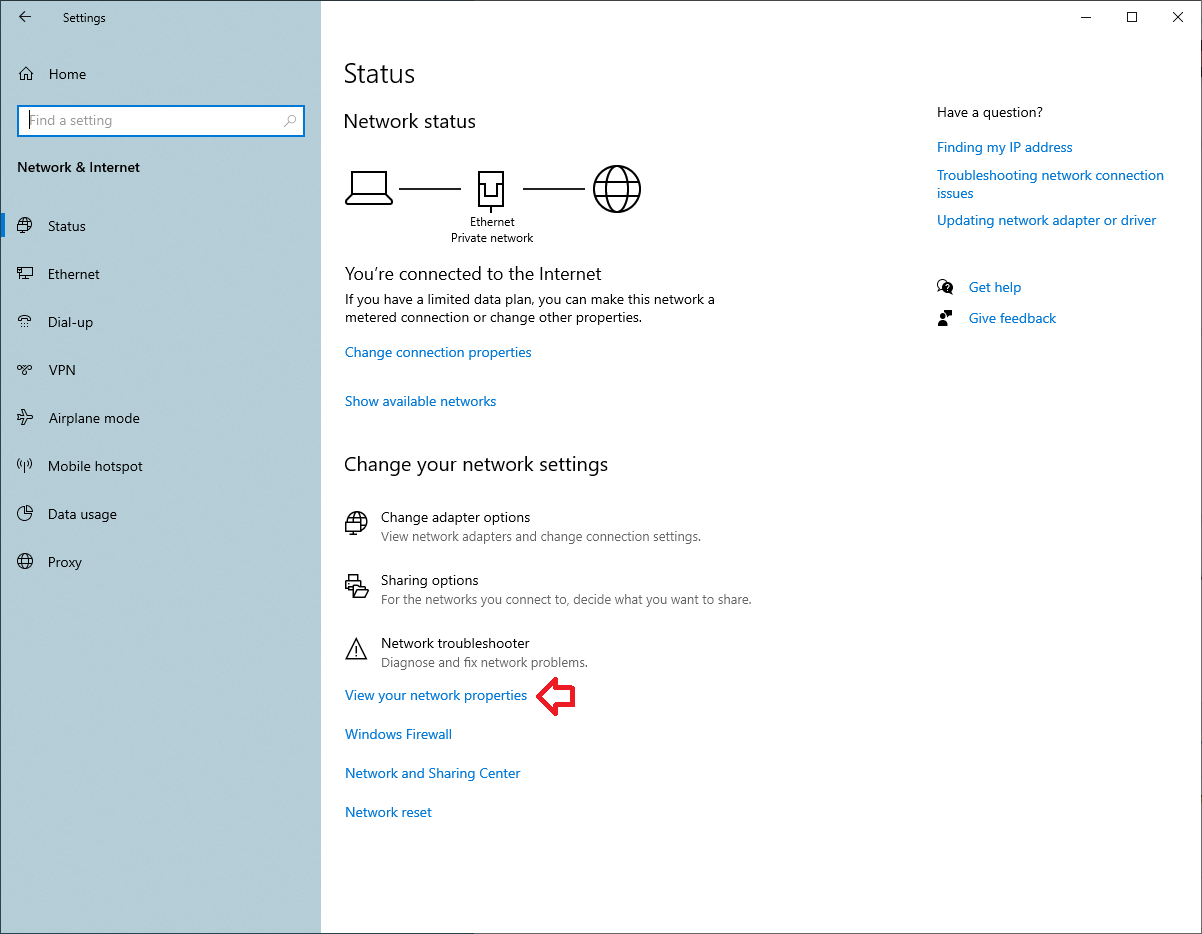

Use the same DNS servers and domain as your PC. You can see these in Settings->Network & Internet->View your network properties.
Samuel Tai
Apr 24, 2020
5,399
In fact, assuming your FreeNAS installation is on the same subnet as your PC, use the same gateway, too.
