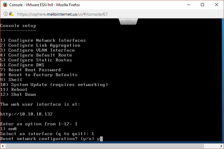

melloa
May 22, 2016
1,749
Try 1, select your interface, and Y to reset it. After that, reconfigure it.

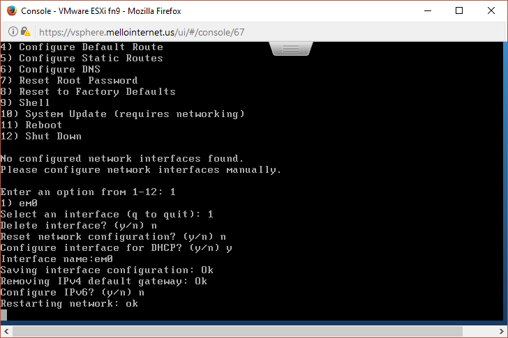

melloa
May 22, 2016
1,749
Configuring to DHCP
