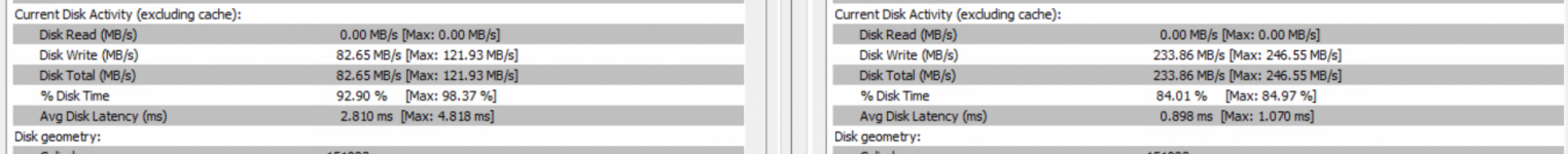

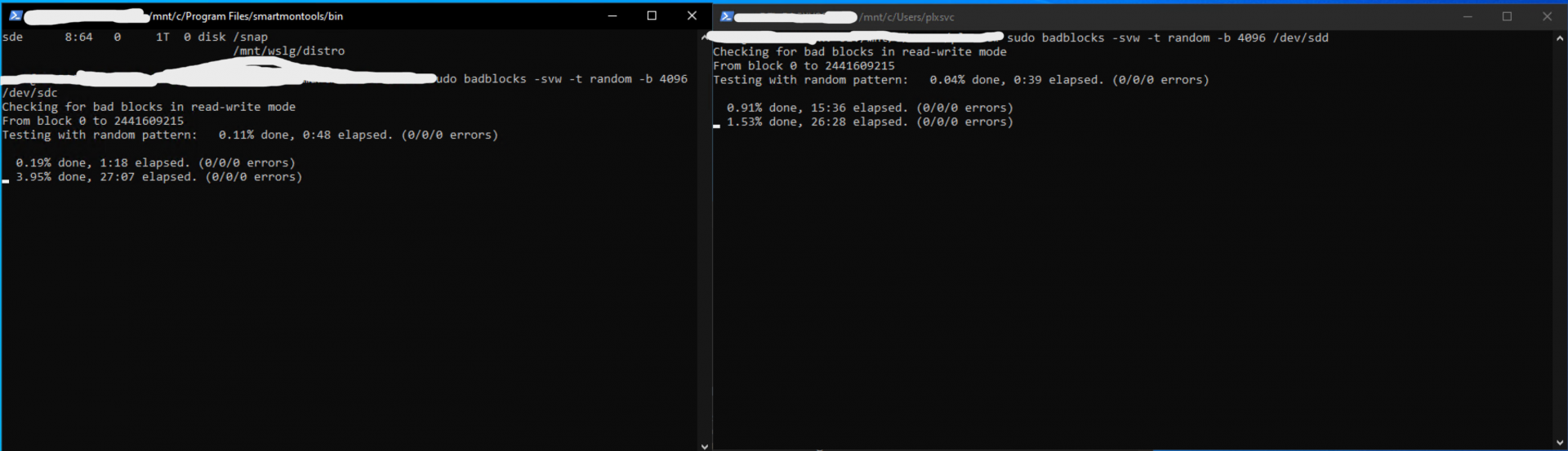

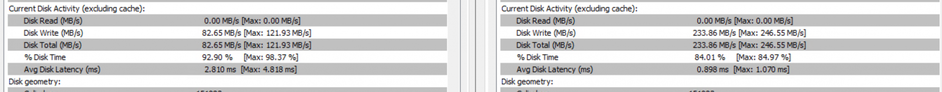

That went great from an early perspective, no issues there, and I've now started my burn-in process using BadBlocks with the drives mounted to the local WSL2 Ubuntu instance. Interestingly, the Generic AB01 firmware drive is running about twice as fast, percentage wise, than the Cisco A3Z4 one...
After 20 minutes of "sudo badblocks -svw -t random -b 4096 /dev/sdx", A3Z4 is at 1.2%, and AB01 is at 3.3%. Quite a significant disparity. Additionally, the disks are also reporting significantly different perf numbers - with the Cisco having much higher latency and slower performance than the Generic (see screenshot). The Cisco is performing like a 5400RPM drive from the early 2000s, and the Generic is performing like I'd expect a few-year-old DC drive to. o_O
Unfortunately, these runs typically take a few days, so it'll be difficult to gather more data to ascertain whether or not these are just two wildly different performing drives, or if one is having issues or not, of if the firmware truly resulted in that degree of a performance bump. I did a quick smart test and viewed the error counts on both before BadBlocks, and it was straight zeros on both, so no signs of early failure there.
After badblocks, I typically run a long-smart (which takes another day), and view the counts again to be sure the drive is GTG.
This time around, as long as my NAS doesn't lose a 3rd drive this month, I might experiment more on this by flipping the firmware versions on these two drives, and rerunning badblocks and some other tests to see if the performance moves with the firmware or stays with the drive.
If the firmware really does result in 3x the perf gains, boy do I want to update the 16 drives in my NAS to that version, as then being on A3Z4 for my pool could very well be the contributing reason my 10TB Drive resilvers are 60+ hours. That said, I'm still having trouble finding an answer to my question #2 - if there's a best practice to updating the firmware of drives in an in-use pool or if anyone has experience doing such.
