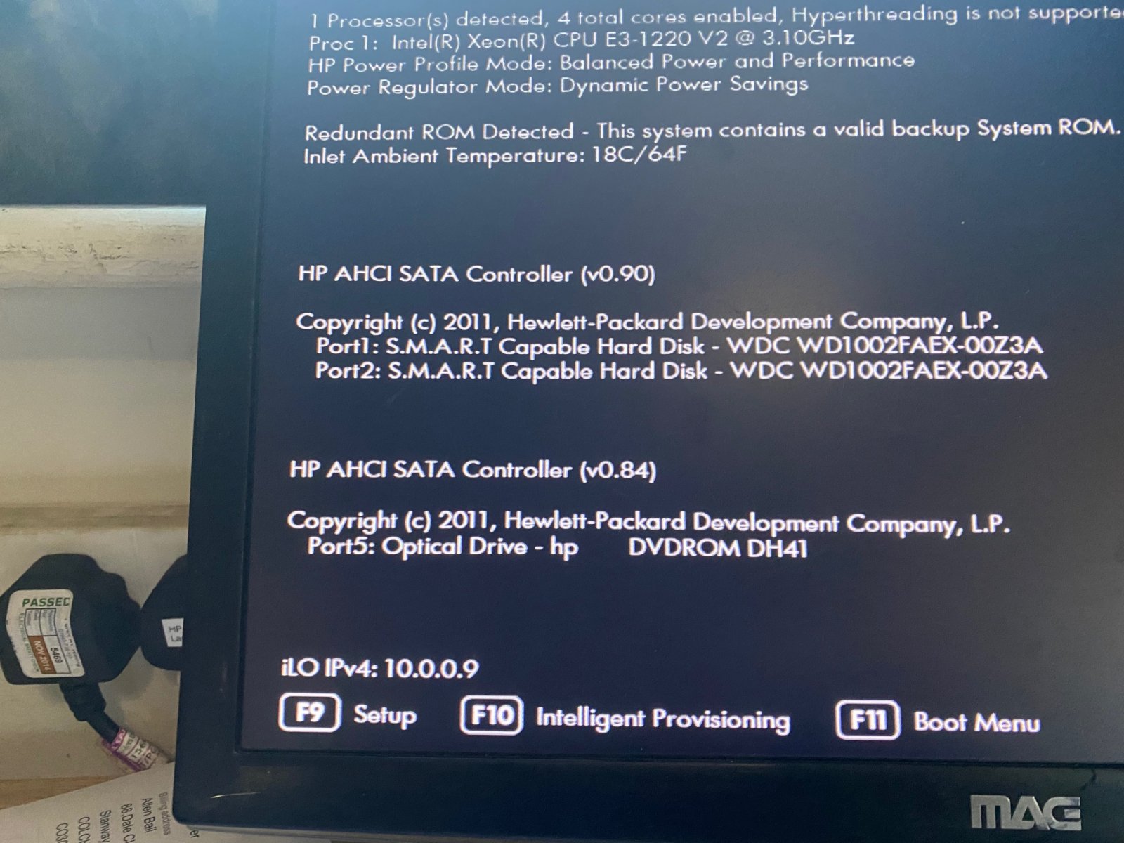

dolphinit
Feb 17, 2020
6
Yeah when you change to AHCI you have the 2 ports on the board as 1 controller and the 4 ports that are in the backplane as a 2nd controller. Ive attached a screenshot of post on mine
