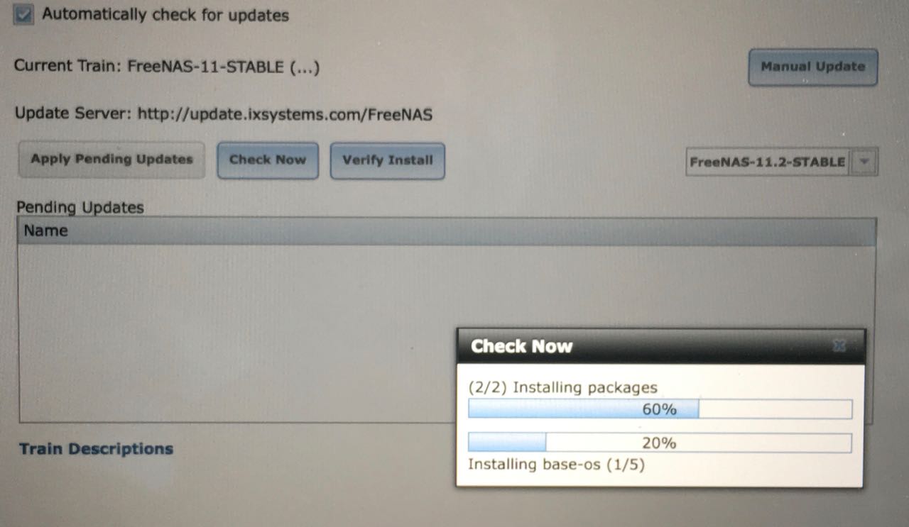

Sorry for the delay in responding to this. I had been sidetracked on other stuff, but today I got back to trying the upgrade again. Here is how it went (As far as I am aware this is exactly what happened the previous two times, it's just that I took a much closer look at what was going on this time).
1. Went to System/Update and selected the 11.2 STABLE train.
2. Clicked Check Now
3. The system found the update and I clicked to proceed with the checkbox to install after downloading completed checked.
4. The update downloaded and performed the update and subsequently rebooted the system

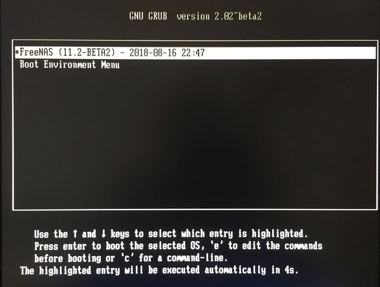

5. Following the reboot the usual GRUB screen was displayed
6. Followed by "Booting 'Normal Bootup'"

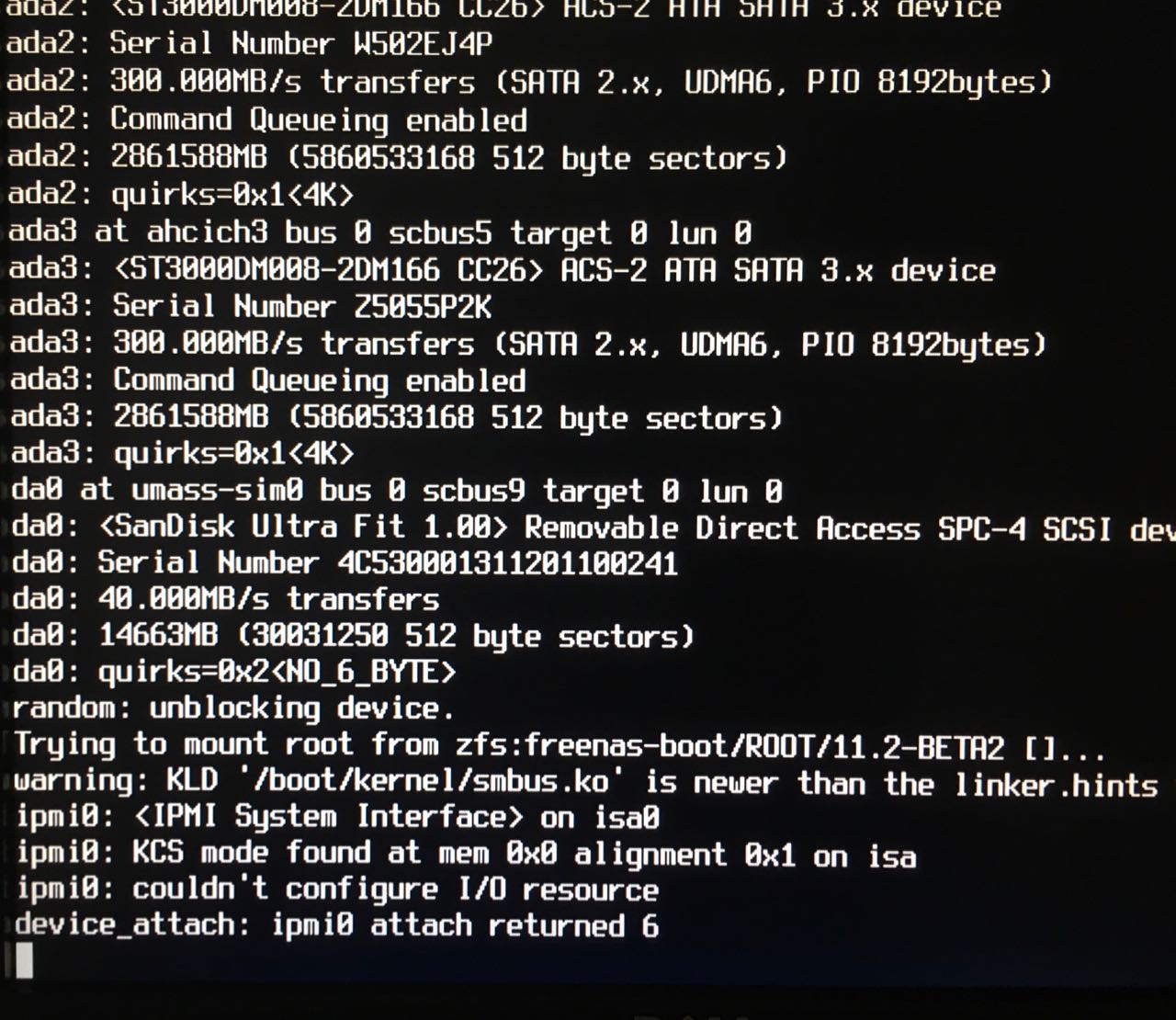

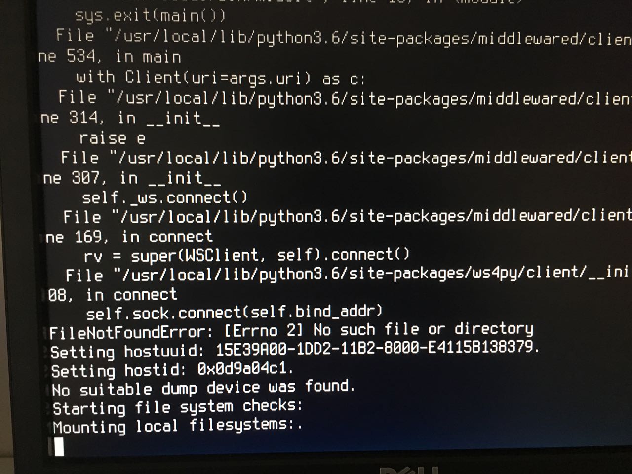

7. Booting then proceeded. I have attached a few pictures of the key moments during the boot process.

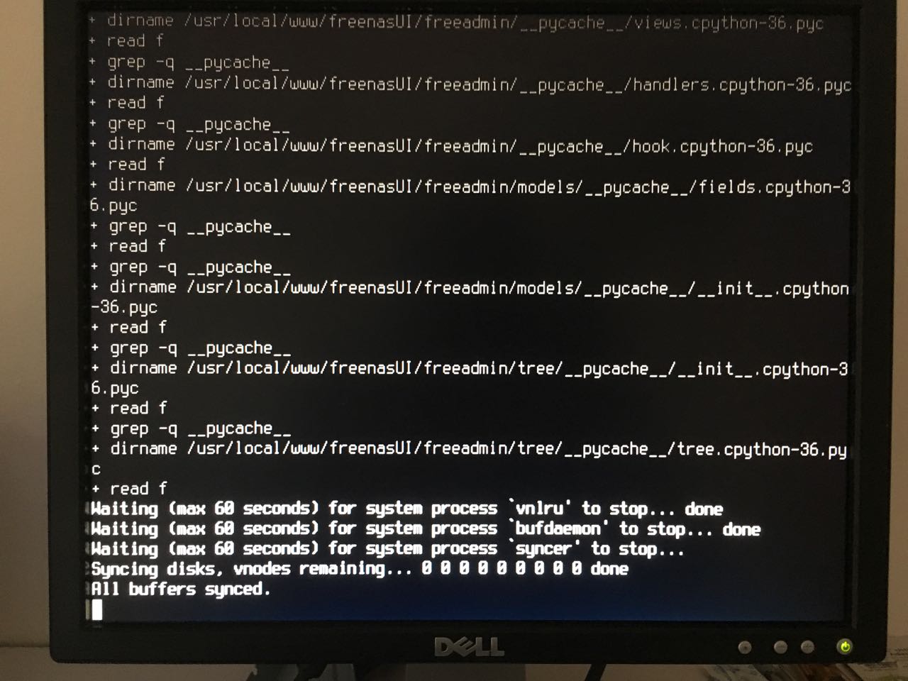

8. The following image is the last screen before the system rebooted again. I don't know whether this is normal.

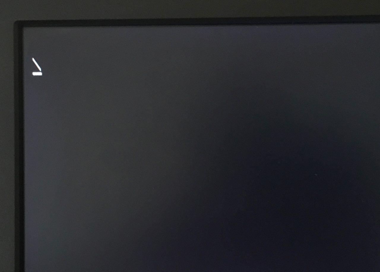

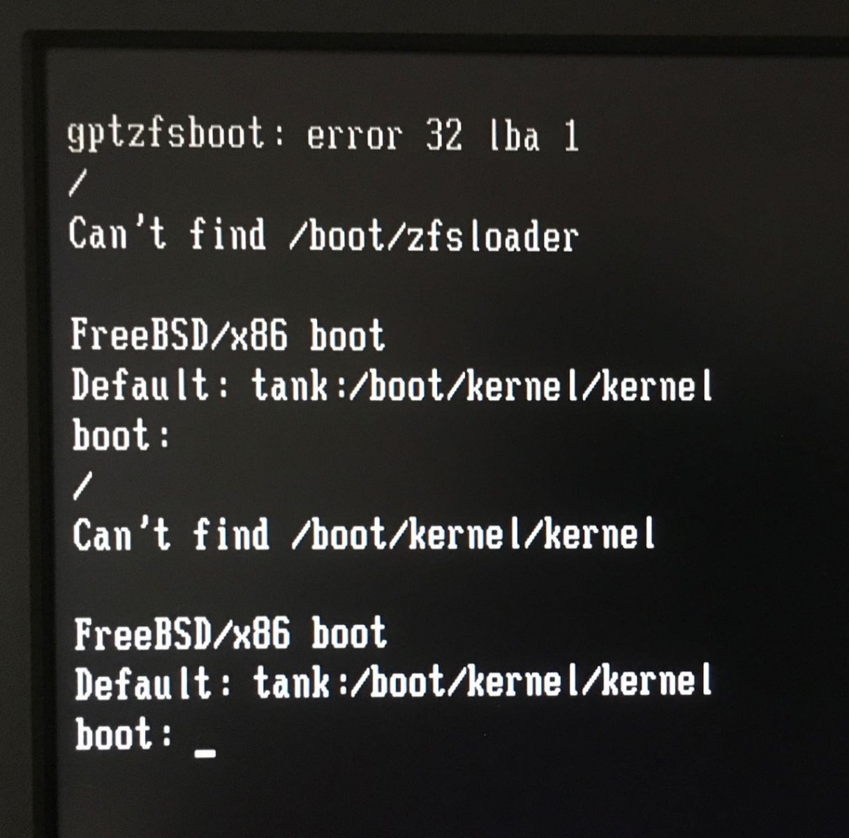

9. Following the reboot a screen appeared containing a "-" with a flashing cursor underneath.
10. After about a minute the "-" changed to a "\". This remained on screen for a further 15 minutes before the final screen appears.

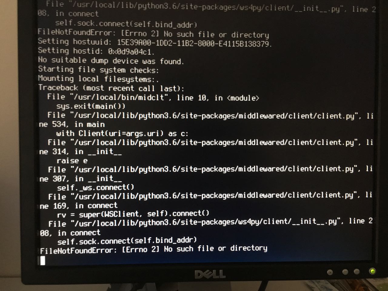

11. This appears to be trying to boot from my main ZFS volume called "tank".
12. Unfortunately, I can not get back to 11.1-U5 on this boot disk, so I can't access any logs.
What should my next steps be?

Two things may have happened here:
1. the boot device died. Does installing to a new boot device result in a bootable system?
2. the update was interrupted and was incomplete. If you naviagate to the "Boot environment menu" in that 2nd screen, which environments are available?
I suspect #2 is the more likely cause as it's still showing the grub screen and 11.2 uses the bsd boot loader instead of grub.

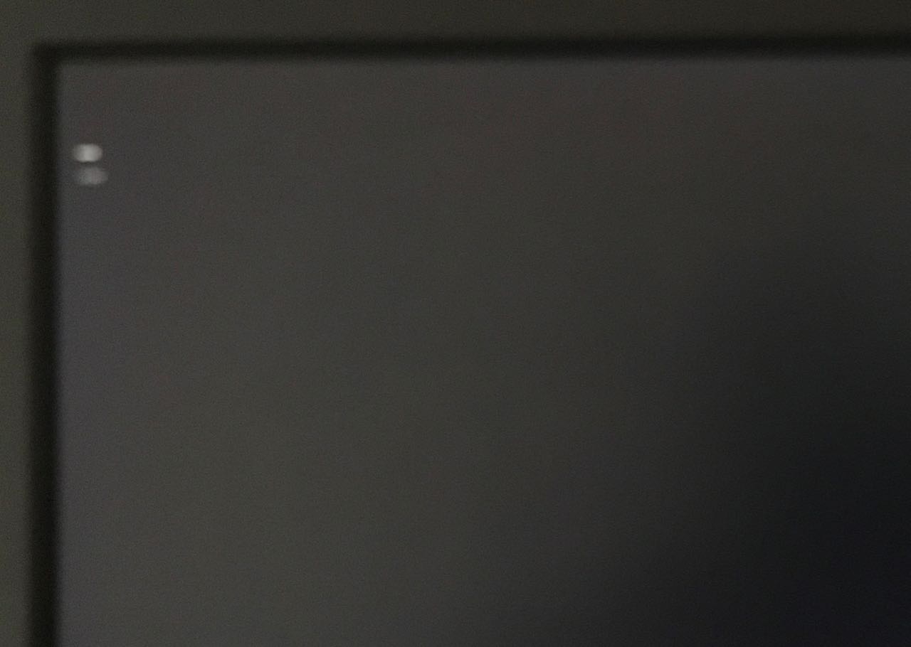

I got 11.1-U5 up and running again and have now tried trying to install 11.2-Beta2 from a brand new Sandisk Ultra Fit 32GB USB 3.0 Flash Drive.
All I get is a grey screen with a white cursor flashing in the top left hand corner. It's been sitting there with no changed for over 45 minutes now. There appears to be a lot of network activity, but not much else going on.

I am completely puzzled by this. The USB flash drive I am booting from displays “BTX version is 1.02” on the screen when I try to boot it on my old Windows laptop, but on my N40L I just get a blank white screen.
I have only got 8GB of memory, where the guy you quoted has got 16GB. I can’t think what it doesn’t like about my setup.

I am a bit puzzled as to why the error messages are talking about failing to find the /boot/kernel/kernal on my tank volume, which is my main ZFS volume. Surely it should be looking for the boot/kernal on the USB boot drive.
Is their something I can try from the boot: prompt ?

Just to add to this thread. I have a N40L microserver with 8GB RAM and I am experiencing the exact same issues as Tony. I downloaded 11.2 for a clean install and was met with a grey screen with flashing cursor in the top left. I confirmed checksum, i tried multiple usb drives to no avail. Tony's response regarding 11.1-U5 was equally valid and after downloading that I am successfully up and running. Definitely something amiss.
