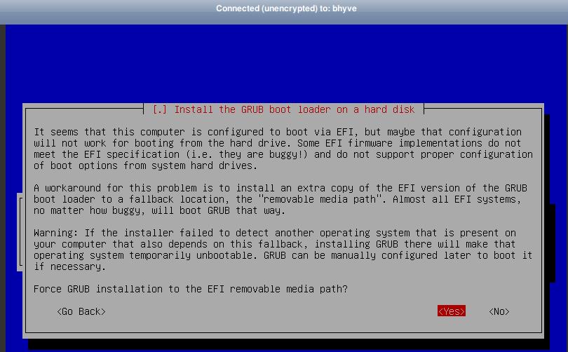

Unlike say later versions of Ubuntu. Debian linux does not "Force grub-efi installation to the removable media path" by default (see: https://wiki.debian.org/UEFI#Force_grub-efi_installation_to_the_removable_media_path ). It can done during the install if you use expert mode, or post-install by using the command shown in #146 above.
Currently, FreeNAS does not emulate ejecting a disk from a cdrom device. Removing a CDROM device after a VM install can cause your to lose network connectivity if the bhyve slot number the virutal NIC is attached to changes. This in turn changes the "Predictable Network Interface Name" inside the VM.

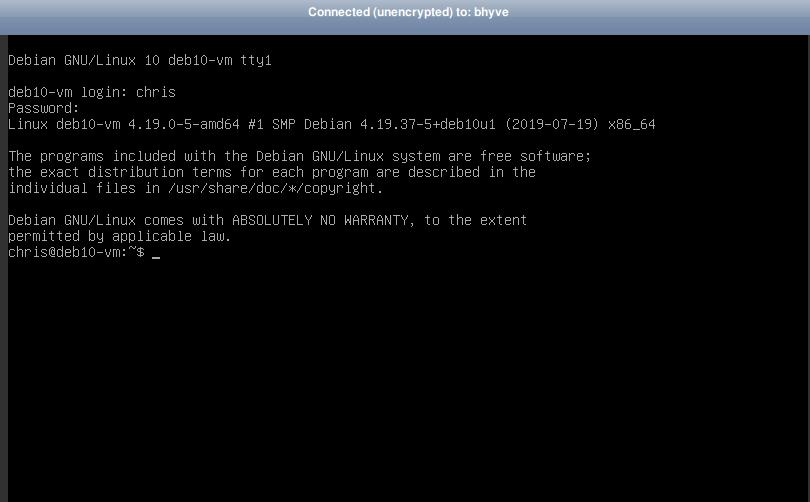

Deb10 installs for me. Usual caveats re: using advanced options > expert install and answering yes to install grub to EFI removable path ... Pre install set VNC res to no higher than 800x600 and booting after removal of cd-rom device requires editing of /etc/network/interfaces to restore network connectivity.
