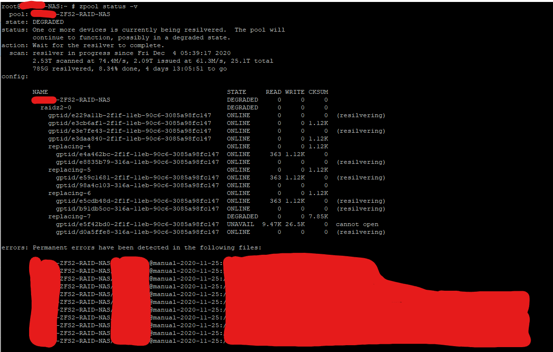

Looks like it restarted. The question: Is it the same drive, or a different one?
You can get more info by running:
# zpool status <poolname>
From an ssh session, or even the UI shell.

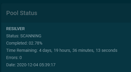

I think it was foolish of me to click Replace on 4 drives simultaneously.
Tested some of the files with "Permanent errors" and was able to open them, no noticable errors in them.
I am not able to tell if the Resilvering is going good, looking at this image though.
